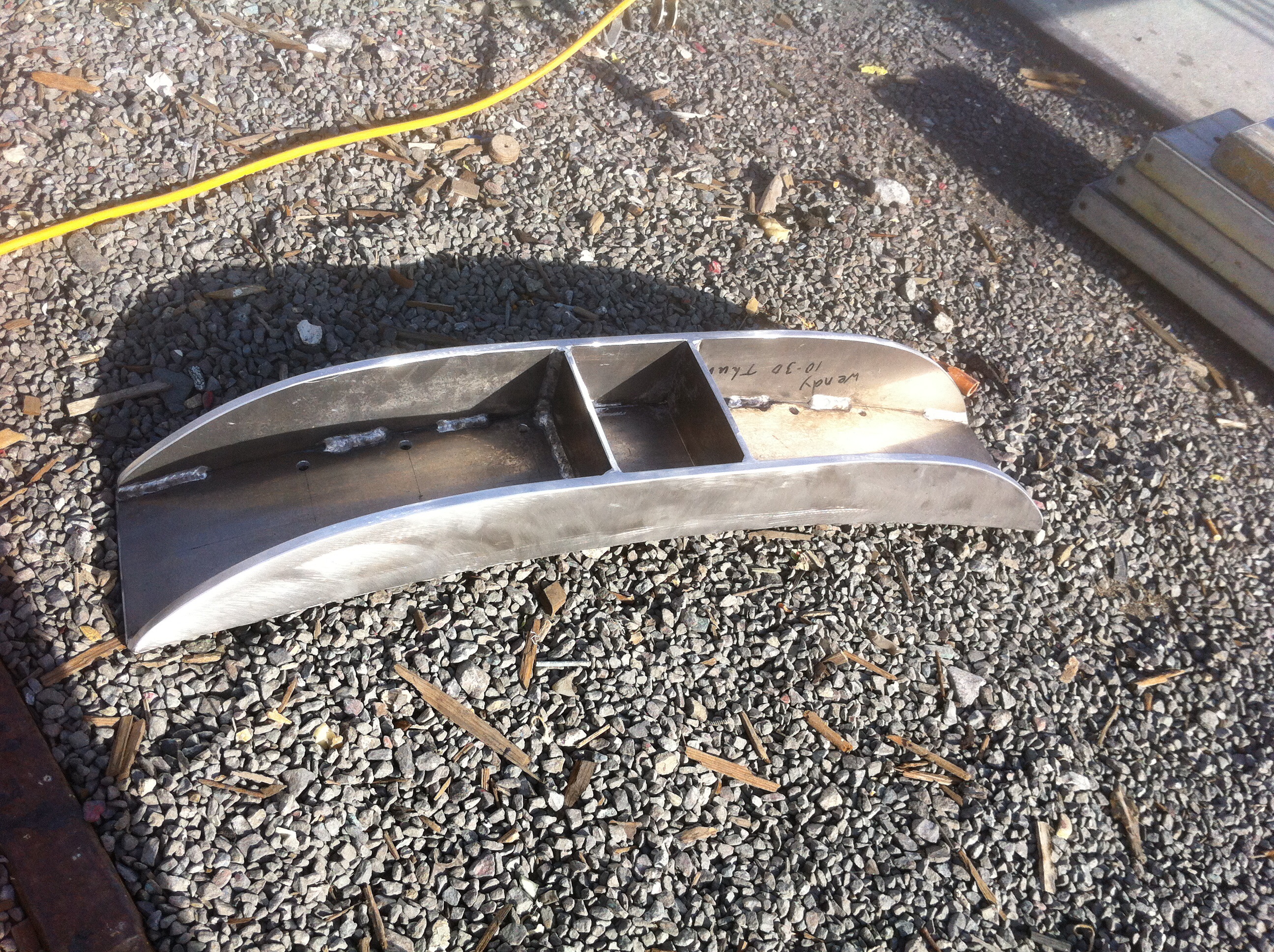

Postby Mike » Sat Oct 03, 2015 4:46 pm
Here's the finished piece!
Came in at $340.
Michael.
Mike
Posts: 27
Re: Aluminium mast base/girder
Postby Phillip » Sat Oct 03, 2015 6:46 pm
Looks great Mike, BUT
You need 4 drain holes; one each in the corners of the central square in which the mast sits.
Postby woodsy » Sat Oct 03, 2015 9:44 pm
Thanks for the photo Mike!
No offence intended but the holes need to drain out fore & aft and/or port & starboard.
Don't drill through the base
Yes I know its obvious but we've all done something similar & then had to correct it.
Cheers.
Larry
woodsy
Posts: 138
Postby Ianb » Mon Oct 05, 2015 12:30 pm
Sorry to be an engineer, but the welds should be continuous to seal the gap. They do not have to be big structural ones, just seal welds. Gaps lead to crevice corrosion.
Ianb
