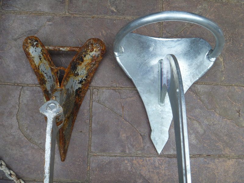

My old CQR anchor had rusted badly so I had epoxied it to extend its life by a few years, but it had again rusted so it was time to replace it. All the magazine articles reviewing anchors indicated that the "new generation" anchors are much better than the older designs. I had been reasonably satisfied with my CQR but it had dragged a few times, once when a 180 degree wind shift occurred and another occasion when I anchored off a city beach. I was ashore and noticed my boat moving towards some moored boats. Fortunately I was able to get back on board in time. I found the cause to be a pair of jeans caught around the fluke of the anchor and preventing it digging in.
The "new generation" anchors apparently dig in more more quickly and reliably, and provide higher resistance to dragging. Unfortunately none of the "new generation" anchors of suitable weight will fit in the anchor well of a Mark 3. They are all too high and many are also too long. I wanted to keep the anchor in the well so that the bow roller is available for my mooring chain.
I narrowed my choice down to a 12 kg Kobra and a 11 kg Manson Supreme. Both had excellent magazine reviews. The Kobra is available on ebay for $170 and the Manson is more than twice that price. However I chose the Manson because it is shorter and because Rob Lovelace wrote so favourably about it on this site a few weeks ago.
The photo below shows the new and old anchors. They are the same weight but the new anchor has much larger area so should have better resistance to dragging.
CQR v. Manson supreme.jpg (151.62 KiB) Viewed 6923 times
After I bought the Manson I found it to be longer than indicated on the Manson website. It fits in the length of the anchor well but with only 1 cm to spare.

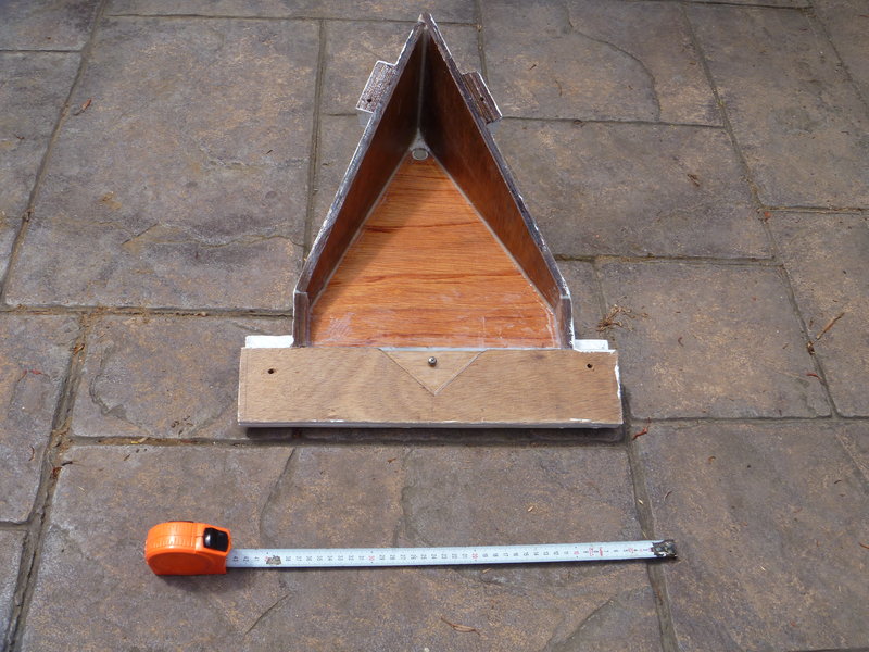

To accommodate its height, I cut a hole in the bottom of the anchor well and fitted a plywood and epoxy box to the underside of the well. This is similar to what Troppo did when fitting his electric winch, but the box is much smaller and localised.
The photo below shows the plywood and epoxy box before it was fitted.

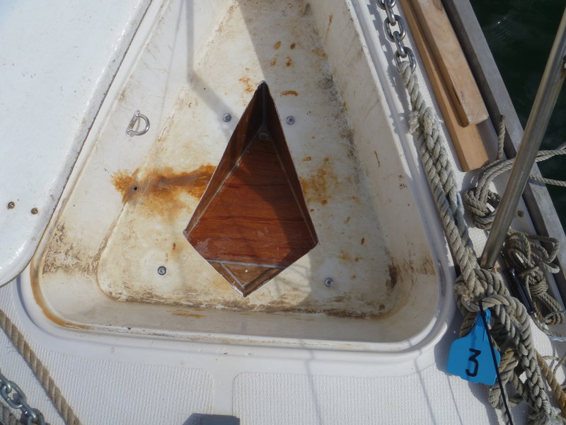

The photo below shows the hole cut in the bottom of the anchor well with the plywood box fitted below it.
Plywood box in position in anchor well.jpg (124.85 KiB) Viewed 6923 times
At present the box is only bolted and sealed to the underside of the well. I will probably epoxy and glass the joint when I have access to mains power so I can grind the rough edges of the cut fibreglass to line up exactly with the plywood sides.

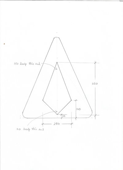

I have also purchased a Manson Supreme for my Mk111 Toppie and would be interested in getting the dimensions of your plywood extension - it certainly looks a better solution than leaving the new anchor on the second roller.

Postby steve » Mon Dec 29, 2014 2:26 pm
Kevin,
I am attaching a sketch showing the dimensions of the cut-out (kite shape) in the anchor well. Also indicated are the depths of the plywood extension. If I was making mine again I would make the plywood extension kite shaped to match the cut-out.
Anchor well cut-out for Manson Supreme.jpg (12.64 KiB) Viewed 6754 times
Steve

Postby KJD13 » Fri Jan 02, 2015 4:57 pm
Thanks Steve, much appreciated.
