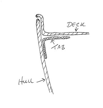

Postby steve » Thu Jan 29, 2015 9:07 am
In the "drawings" sub-album of the Mark 3 photos library there is a drawing of how the factory did the hull to deck joint on Mark 3s.
Steve
steve
Posts: 98
Images: 14
Postby Troppo » Thu Jan 29, 2015 9:12 am
steve wrote:In the "drawings" sub-album of the Mark 3 photos library there is a drawing of how the factory did the hull to deck joint on Mark 3s.
Steve
This one I think.
