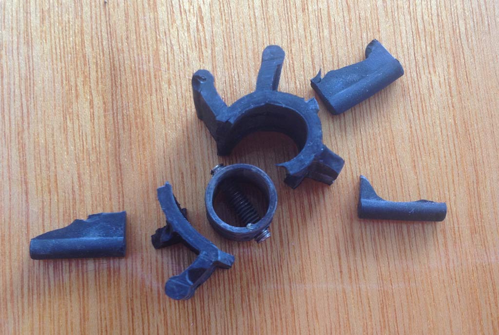

Well having spent a day on my back yesterday I’m much improved today.
First job today was the diesel engine. Checked the oil first and it was black, normal for diesel engines so no water has entered the system. Next off came the impeller cover and there it was, all busted up! That was a great relief and even more so when all the bits were there. After replacing the impeller I next checked the whole system for blockages and found none. While doing this I was soaking then head of the anti-syphoning devise, which is brass, in vinegar to clean it. With everything back in place I starter her up and away she went, no trouble at all. Mind you all this took two hours to carry out and I am sure that I would not have been able to do it at sea.
