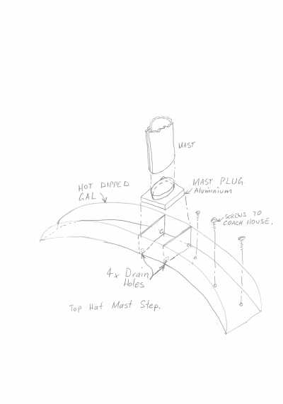

Here is the arrangement of the mast step on Felicite. I don't know if its identical to what you have. Mine was filled with araldite in the centre section by someone who obviously had a great idea, probably at 3am on Sunday morning. I hope the sketch helps.
Top Hat MK 3 Mast step.JPG (7.36 KiB) Viewed 9817 times
There are 4 drain holes in each corner which you should have, you're right. THey may have been clogged with gunk or maybe even Aradite. WE only found that out when the rigging was redone by Paul Minter. The mast plug had to be chisseled out and cleaned up. It has about 2 to 3 mm of slop in the central box from memory. Its made of aluminium.
The weldmentment secton is indeed hot dipped galvanised. Mine is showing signs of rust in a small section. I plan to hit it with rust converter, maybe even POR 15 or so and seal it with sikaflex. I'll hit the bad parts of the weldment with Cold Gal and give it a few weeks to cure. I'll then paint it with Dulux weather shield or so to give it a better appearance.
If you really wanted to do a good job, you could take it off and get it hot dipped again. It costs about $90 for up to 50kg and at last count up here in Newcastle it was a 9 week wait. I don't think so. :o

Thanks for the info. That helps to exlain it and makes it a lot clearer. POR 15 is what I concluded might be the go. Just want to make sure it will not affect the aluminium of the mast in any way. Thinking of getting the starter pack, which has marine cleaner, metal ready and POR15. Will also get the spray pack, as one of the big problems I see is getting the POR 15 between the step and the mast, as there is no room for a paint brush. Moored at Mooney Mooney Creek.

John, I reckon it needs the four holes to allow the water to get away, as shown in Greg's drawing( thought you would of jazzed up the drawing with one of those famous LM seagulls perched on it, Greg :) )
