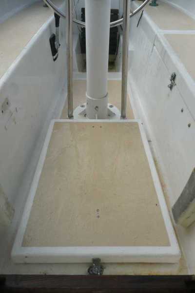

You could if you had a spare day and a Jig Saw cut an access hatch in the deck of the cockpit. Makes access to the engine REALLY easy.

Thanks one and all for effort. Some points I would like to make. Once again stopping water getting below is paramount. cutting a big hole in the cockpit floor doesn't appear to me to be wise if in heavy seas and get any form of excessive water in cockpit as I worry about how watertight hatch is. In general terms can anyone answer how often you need to check/maintain/replace seal and or bearing or whatever system is used for the rudder where it enters the bottom of the hull and through the cockpit and is access easy or difficult. Cheers and happy sailing. Gordon.
