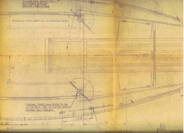

I'll scan the deck layout plan over the weekend ,it might help ? It will give you the distance from the mast to the gunwale etc '. But how are you going to get the sail slot to work with a junk rig ? Because as you move the junk ! ? :? in or out won't that open or close the slot :? :? What you suggested is the way to go .

Had look at the plans don't think they will help there's no detail as such? I guess it will be trial and error
