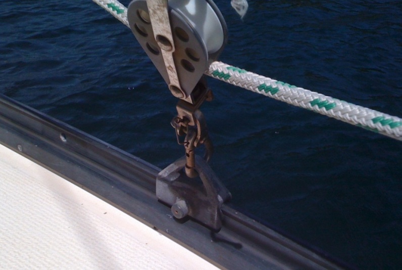

Sea Monkey does not have jib sheet tracks, instead she has cars that run along the full length of the toe rail. Most of the Top hats seem to have a more modern track on the deck that allows sheeting in a bit tighter. Anyway to be exact she has one car as the other one is missing! I had a bit of a look around, but I am unable to locate a replacement, does anyone know where I might find one? I have tried the second hand shop in Mona Vale. I have contacted a toe rail manufacturer, but they don't have cars for the same design of track!
I have also spoken to a fabricator and said I want 4 of them ... he is looking into it, but I have a feeling this may be expensive.
Does anyone have any better ideas?
I have included a picture below.
Regards ... Maggsy (Sea Monkey)

Your last last resort may be to get a new one cast in bronze from the one you have.

Looks like the perfect time to put a couple of tracks on the deck and buy a couple of standard jib sheet cars. I think you will be able to point much higher if you can sheet your head sails further inboard.

Agree that it would be harder to point high - but hey how good would these be for reaching -- or even running with a pole out and the cars aft!! thats pretty smart.
I have the standard two tracks on ours... and find I need the adjustment that having both tracks brings for reaching and pointing.
