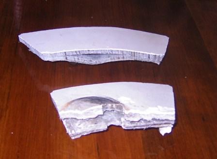

The hulls are joined on the centreline and at the hull/deck joint.
The centreline has an externally layed up layer and the hull/deck has a formed lap with an internal 'tag' running the full length.
Tales is a MkIII and not finished as well as some MkIIs I have seen but the hull joints are very well done.
The only exception being the very front where the bow fitting is attached. The hull/deck lap runs out at the elevated part of the deck and leaked, rotting the wooden block. The lay up would have been done with the operator on his back and some of the layup drooped down.
I have rebuilt that area and reinforced it so it cannot leak.
Have pics if any needs them.
deck layup - bow
