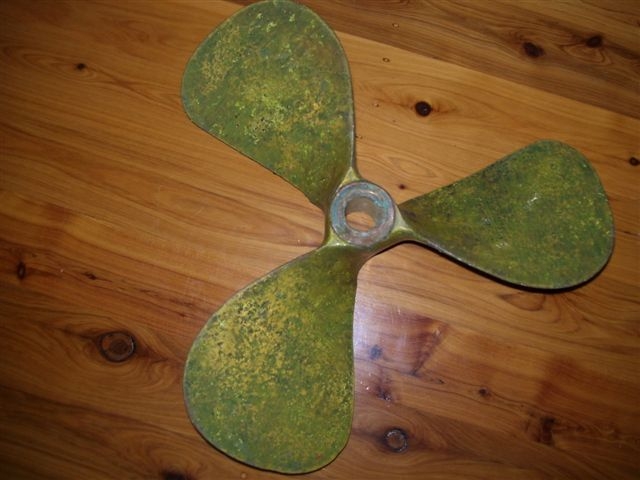

it has been confirmed that my 2 blades propeller had drop off .
I 'm kind of know where about it 'd came off, :)
what should I do now :?
call a diver to look for it,or time to replace a 3 blades prop.(could give me more boat speed)
I need some advice on --
who do I call that does the diving for the prop & refitting services?
or where to pick up a new or 2nd hands prop--- 2 blades or 3 blades?
how much does it cost?
Sylph
8philip8
here's the photo of the old prop
8philip8

you are right, it's better cost wise being the prop then the gear box :oops: the old prop looked quite tired from the photo.it's time due for a new one :)
