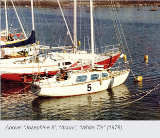

Nick Creech wrote me this when I had a similar query. He is refering to White Tie and the 1978 Solo Trans Tasman.
"The key to drown proofing a Top Hat is to be able to fit really solid storm boards to the windows (I had them permanently bolted in place) and to be able to block the bottom half of the companion way semi-permanently, at least at sea. I left myself only a little crawl hole over a permanent fixture on White Tie, which probably saved her from sinking (got pooped, crash-gybed and partially swamped when she could have filled completely). The lack of a bridge deck is the boat's only real weakness, balanced by the fact that it doesn't have a sliding hatch which is often, itself, a fail point. Not hard to work a positive but removable system. The standard storm boards are a bit of death trap. The taper means they can float out or fall out very easily. If nothing else, they need retaining lines so that you can't lose them altogether."

White Tie in NZ prior to 1978 Solo Trans Tasman

Thanks Tom - looking at the picture of White Tie, it appears to be a form of perspex or plastic - is the storm boards he is talking about some form of plastic clear window that is bolted in place? I guess I am thinking that to make it seaworthy putting very strong plastic -lexan?- and not sure of the required thickness. Also how to attach - as have read in 'thecoastal passage' about using double sided tape and essentially glueing and not using bolts or screws - I would be concerned that it is not strong enough - I will keep learning about this before changing. Cheers Peter

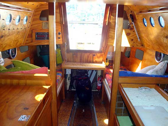

Sea Monkey has been fully timber lined with small portholes on the inside of the perspex windows to allow for ocean journeys.
SeaMonkey Inside.jpg (35.3 KiB) Viewed 11379 times

The White Tie storm boards were boards not plastic.
