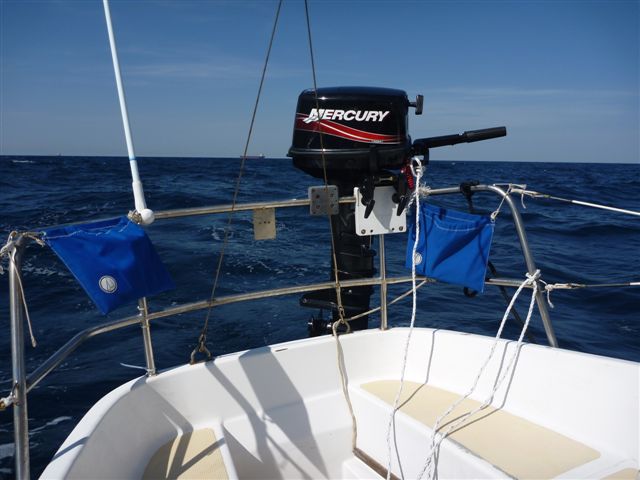

Night Cap has a 2009 Mercury 8hp LS 2-stroke, she used to have an Evinrude 6hp LS 2st, but i didnt trust the old motor 100%, but only because i dont know much about outboards.
The running-in process is a bit annoying for new outboards, but at least you know its been done.
Cruising at 1/2 to 3/4 throttle uses 2lt per hour, roughly 4 - 4.8kts.
Ive read 8hp 4 strokes can use as little as just under 1lt p.h.
The biggest bain is lifting it out of the well & onto a bracket on the pushpit.
Outboard sitting on pushpit bracket
TopHatSailing Mar2010 012.jpg (51.86 KiB) Viewed 15420 times
Your fortunate with the cutout in the transom, enabling you to get the prop out of the water.
When i was reasearching to buy the new motor, i also liked the reputation of the Tohatsu, but i was told that all Mercury's under 15hp are made by Tohatsu, they certainly look identical, merc also included the hi-thrust prop(Tohey hi-thrust props were $200-ish extra), plus the merc's were $250-ish cheaper aswell.
