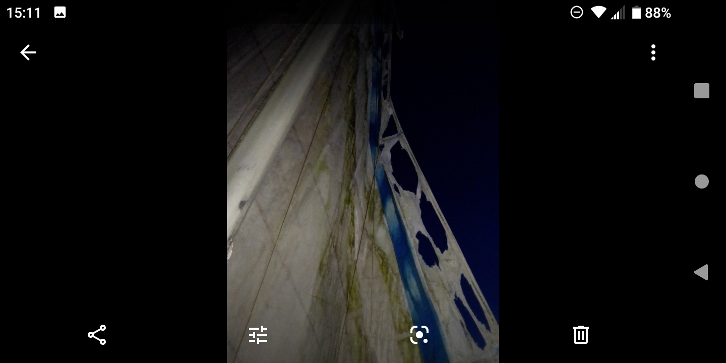

Let's try again, wot! Peter I'm keen to buy your old Genoa if you want to sell it, because the only headsail I have looks 'orrible (see photo). I hope you can get a good 'un to suit your boat, whether from Sailrite or someone else. Best wishes chief, Cheerio.

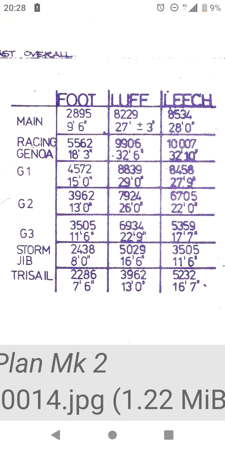

Hi Peter,
The sail dimensions recommended by Formit are shown on a drawing which can be found in the gallery under Mark 3 Top Hats, sub-album Drawings. These sail dimensions are for Mark 3 and are almost certainly the same as for Mark 2 but you should measure your mast height to be sure. Of course you must consider if the dimensions have to be changed so the sheet leads are still OK when partially furled.
I agree that a furling No.2 is great for 15-20 knots but I wonder whether you would find it inadequate and frustrating in lighter winds. I would probable choose a No.1 (called a G1 on the drawing, not the Racing Genoa as that is enormous).
