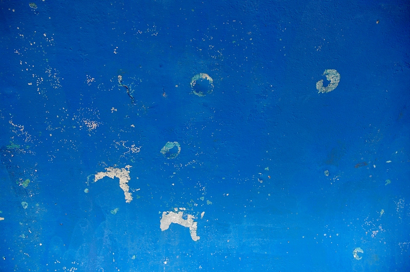

Don't worry too much about blisters. These were on Felicite. At her last slipping last month there were none.
Top Hat hulls are quite thick.

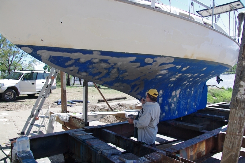

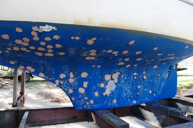

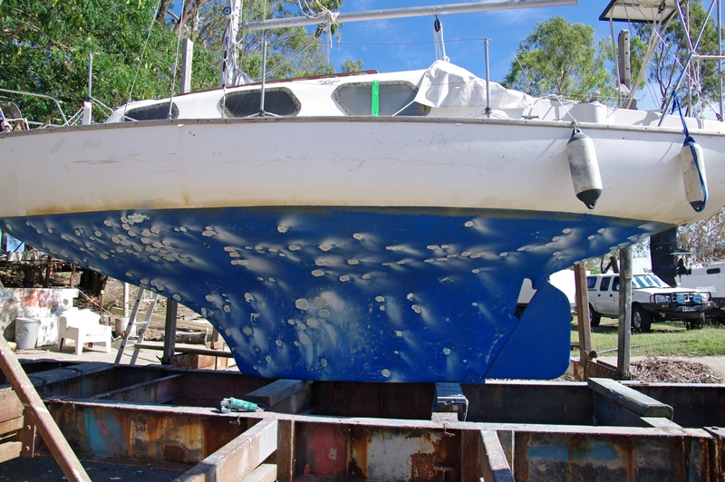

My old Mk 2 Windchaser had a survey done a year before I purchased saying no osmosis. When I had her up on a slip, I noticed some old and large osmosis blister repairs. A year later when up on the slip again I paid more attention as I saw tiny blisters up to 20 cent size on port side of hull, practically nothing on starboard side. Probably there the year before but now a bit bigger and I was looking harder. To confirm osmosis, I punctured blisters with small sharp screwdriver. Dark smelly fluid leaked out.
Photos show port side as only a couple on starboard side.
Ground out shallow depressions to remove affected materials, flushed with fresh water several times over a few days then let it dry out for a few more days while doing (lots) of other repair work. Then did the standard repair with brushing on epoxy, then a layer of fairing epoxy stuff that can go under the waterline, sanded back, primed and painted. The next year there was no problems. Year after that I had sold her so don't know if any more osmosis started.
