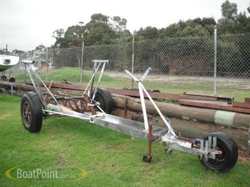

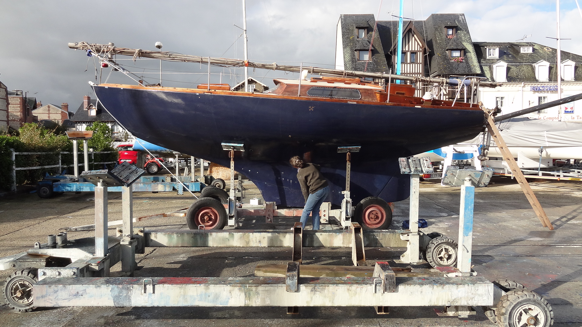

I haven't yet found the photo of a recent trailer that was built in Brisbane, but these will do in the meantime.
Oh, and yes the first Mk 0 displacement was 2.54 tons, ballast of 1.15 tons [not tonnes]
The actual displacement will depend on what the hull was built of.
An English original
DC28 Grapeshot trailer.jpg (459.93 KiB) Viewed 8970 times
