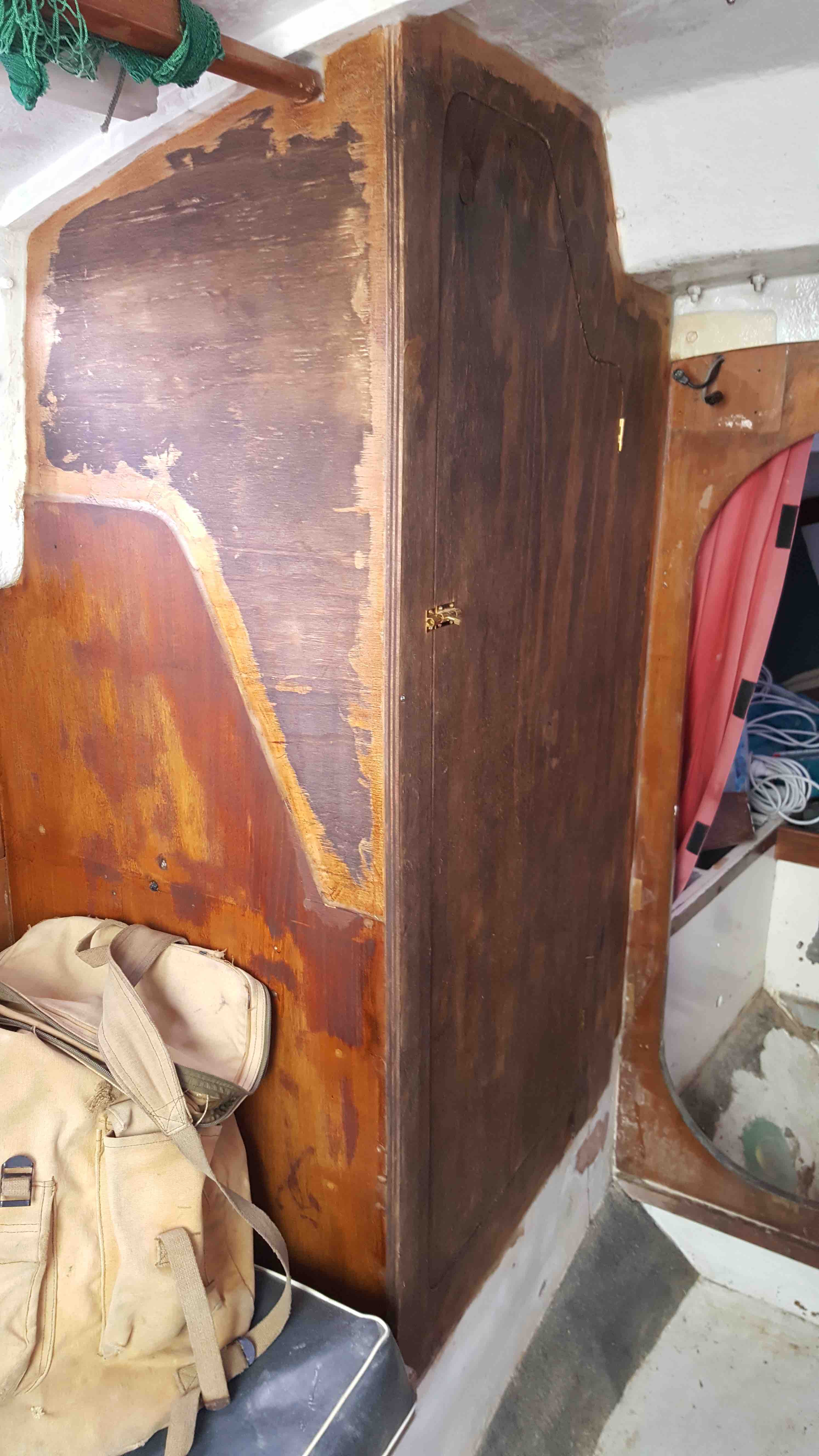

I've had my boat out of the water getting the engine mounts sorted out and have worked on a side project I've been thinking about for a while
The head under the v-berth has been the only part of my boat that i haven't been super stoked on.. it turns into an issue when the girls come along and moving the v berth around when under way is a hassle and sleeping above a recently used toilet not that romantic.

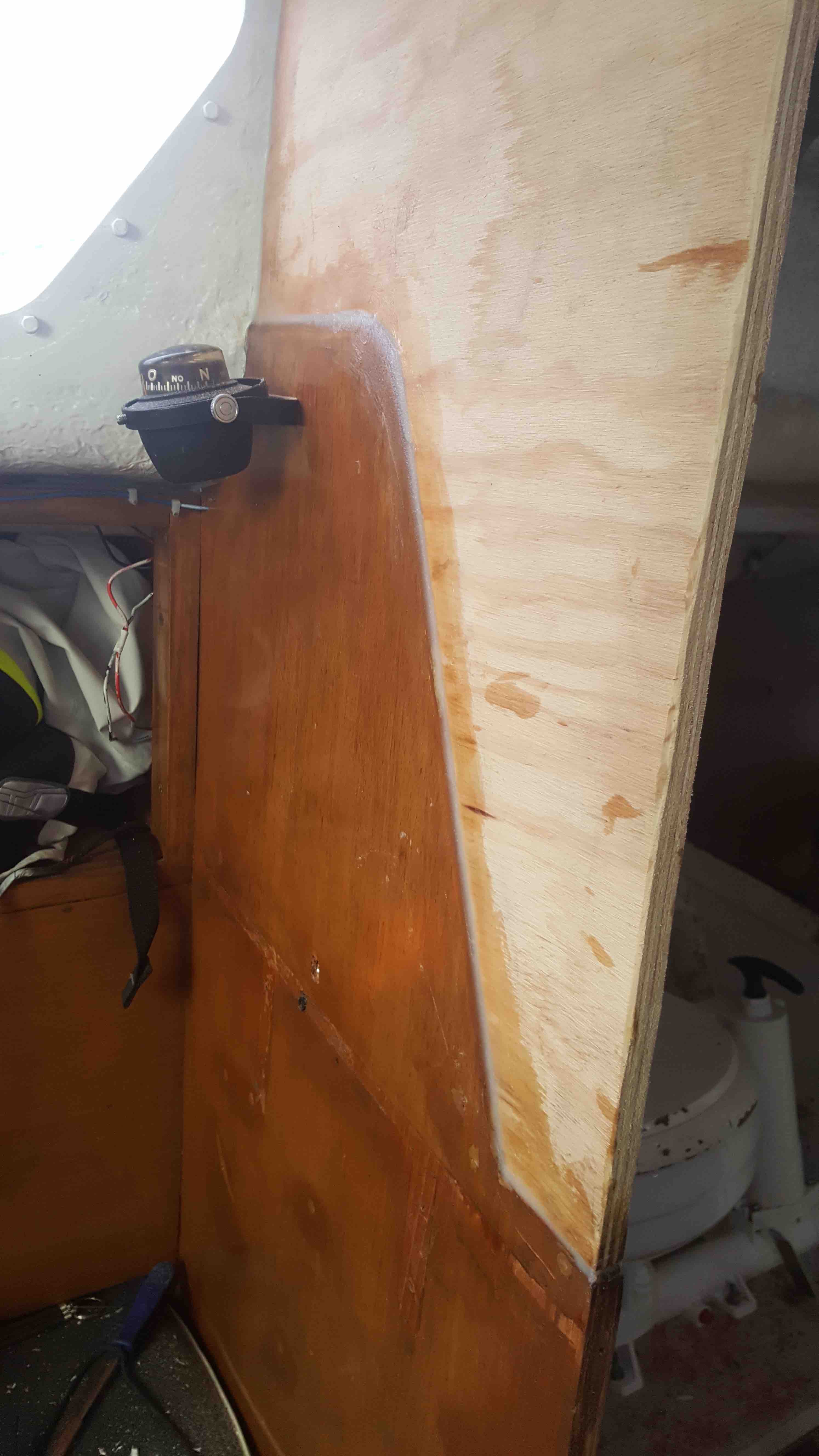

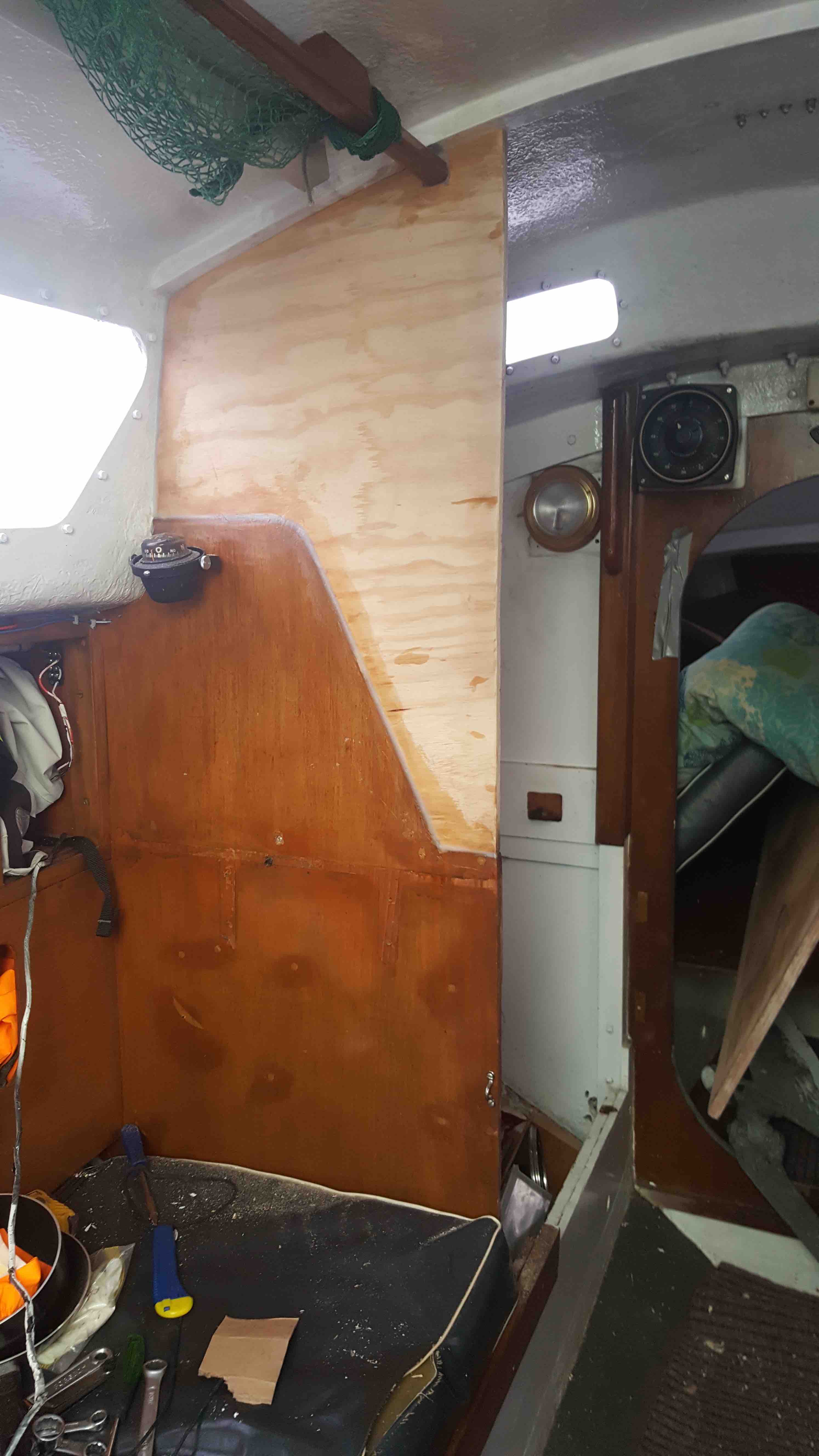

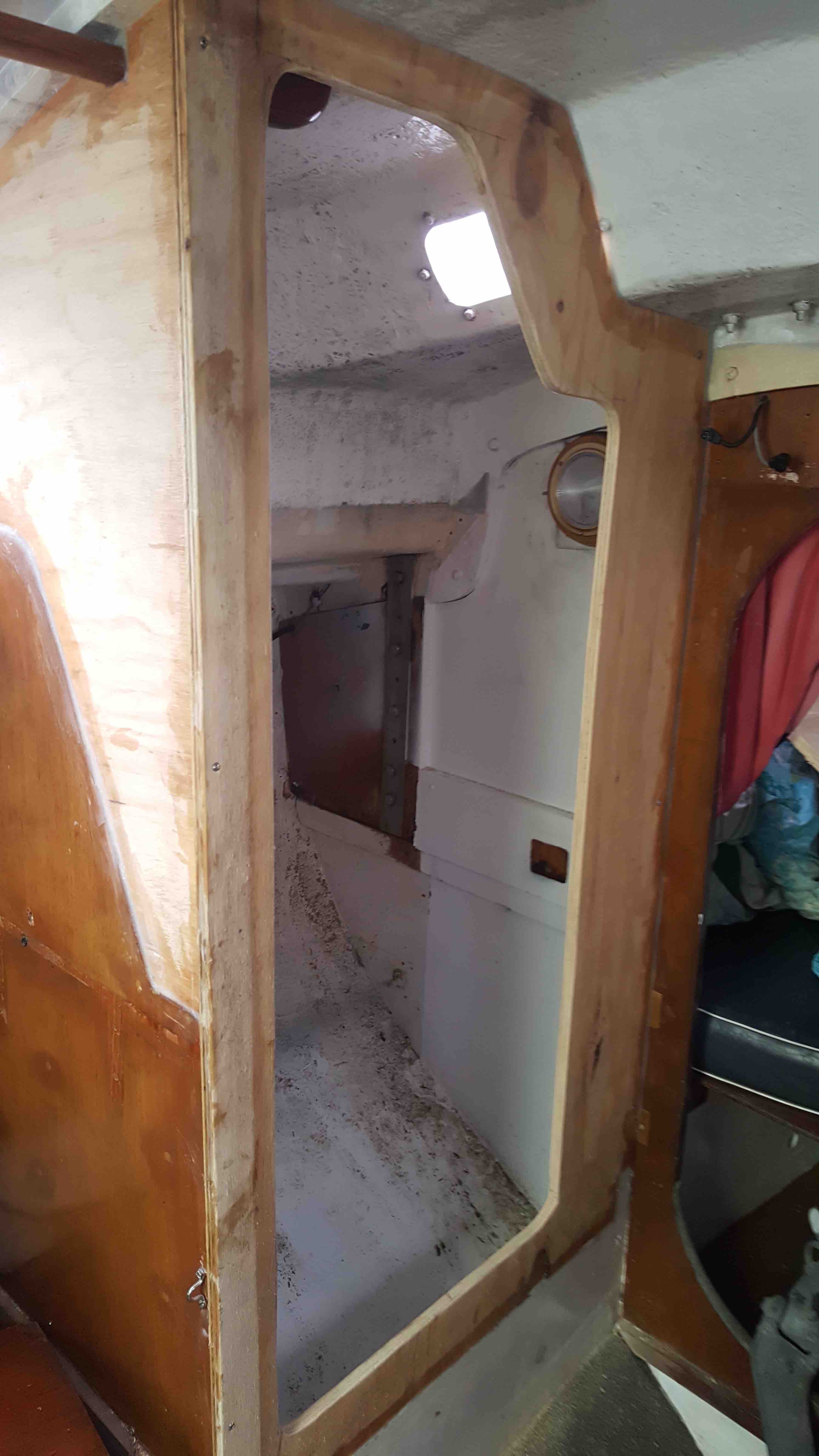

i've been jealous of the stand alone heads i've seen on other tophats so i moved it into the cabin. here's some photos
the toilet is a lavac marine head which a friend of mine has on his boat. direct pump out, no holding tank

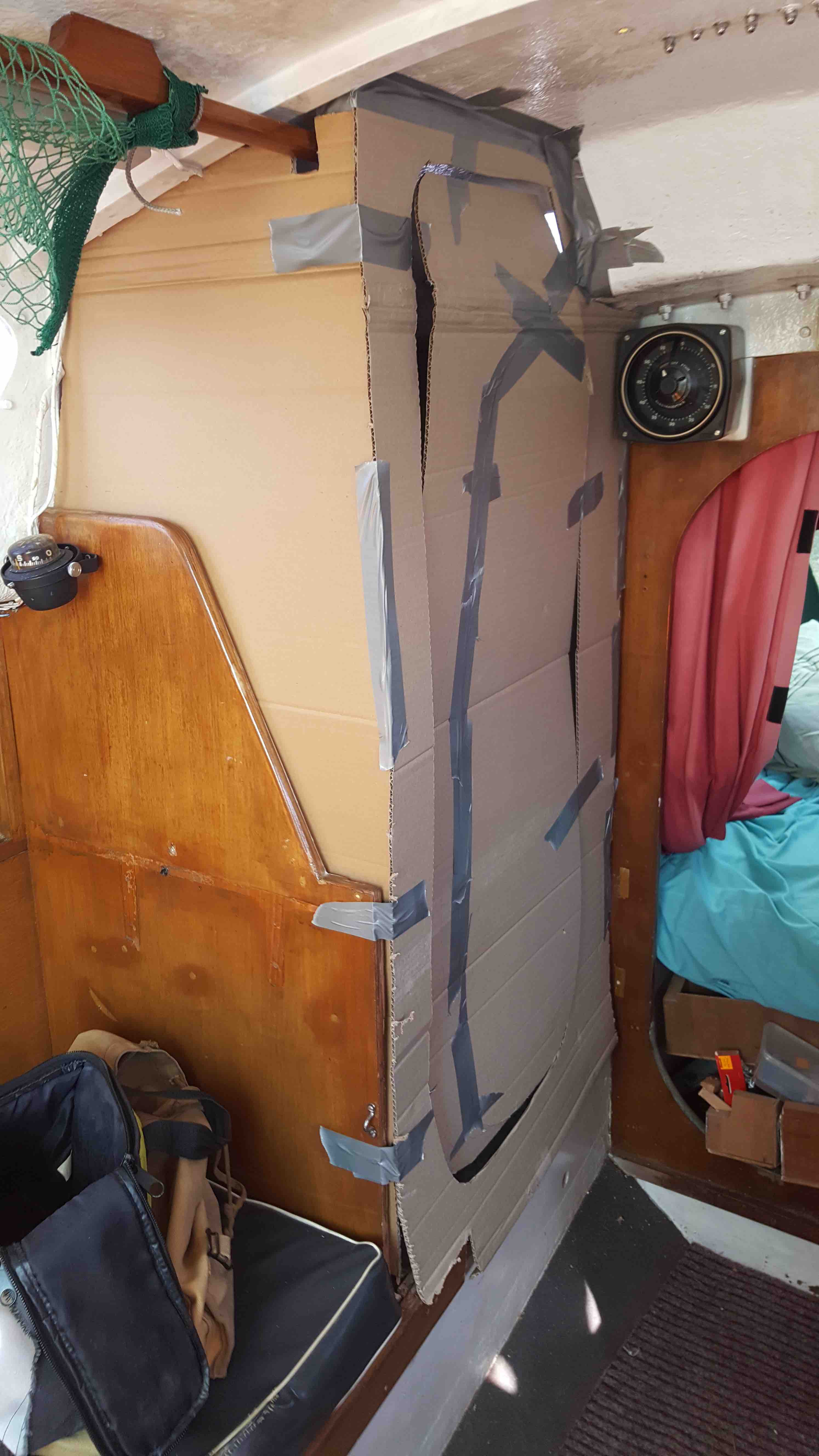

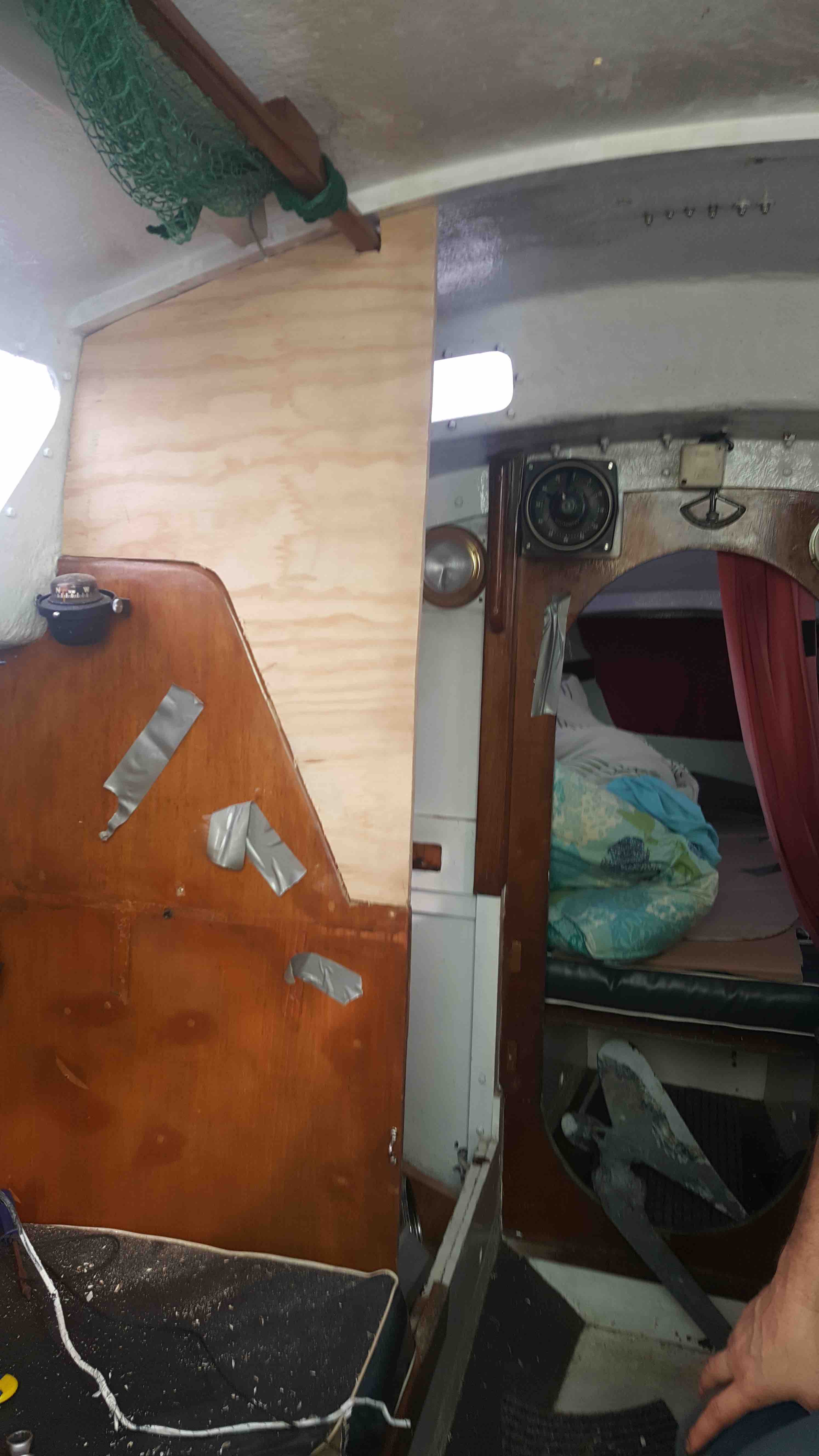

mocked it up with cardboard first
some cabin jigsaw work
got epoxy involved
Thickened epoxy.jpg (383.72 KiB) Viewed 8461 times
Head wall.jpg (389.76 KiB) Viewed 8461 times
more jigsaw work using the cardboard template
put some stain on it which i think looks cool
New head.jpg (472.57 KiB) Viewed 8461 times

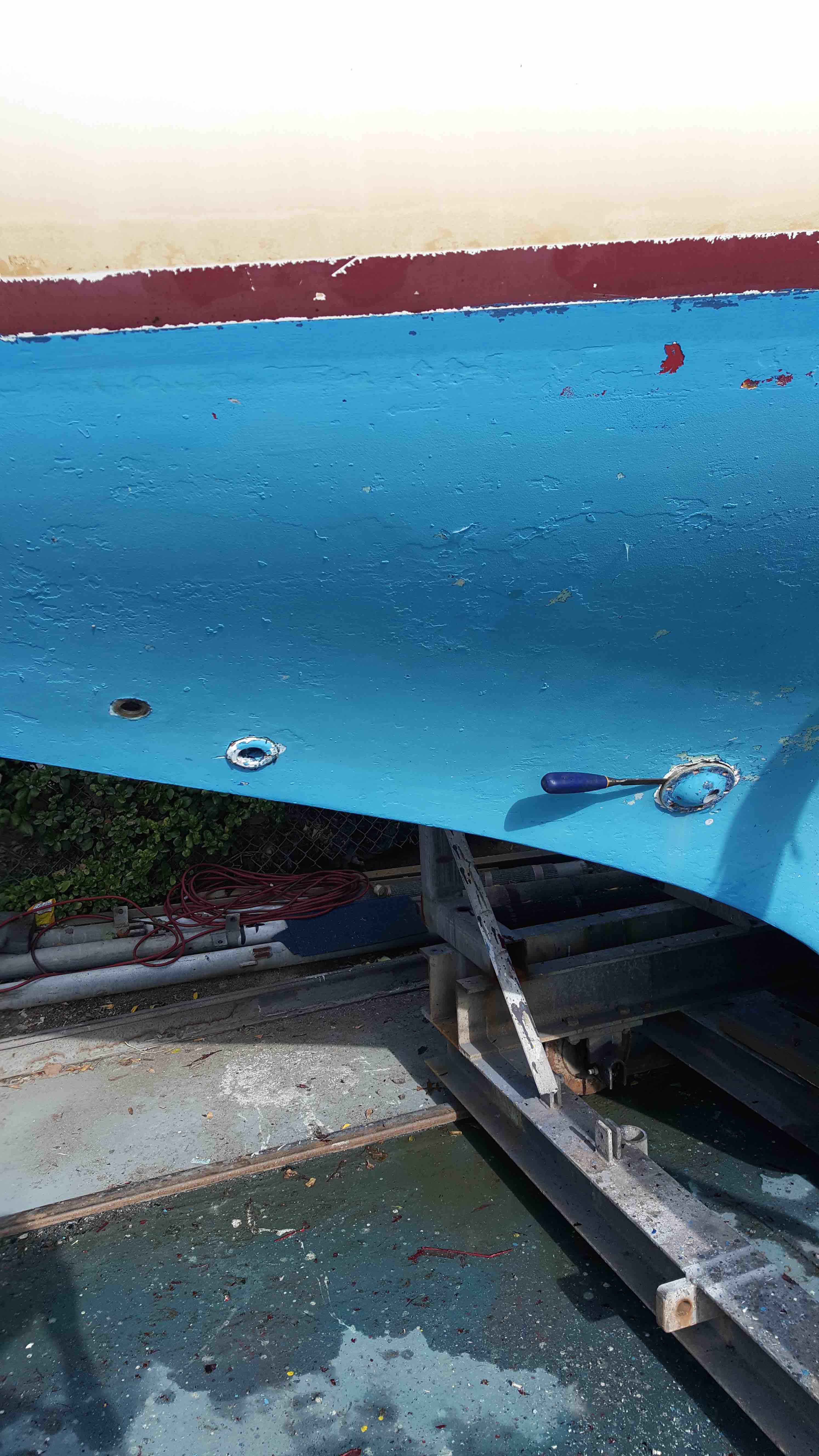

the new toilet

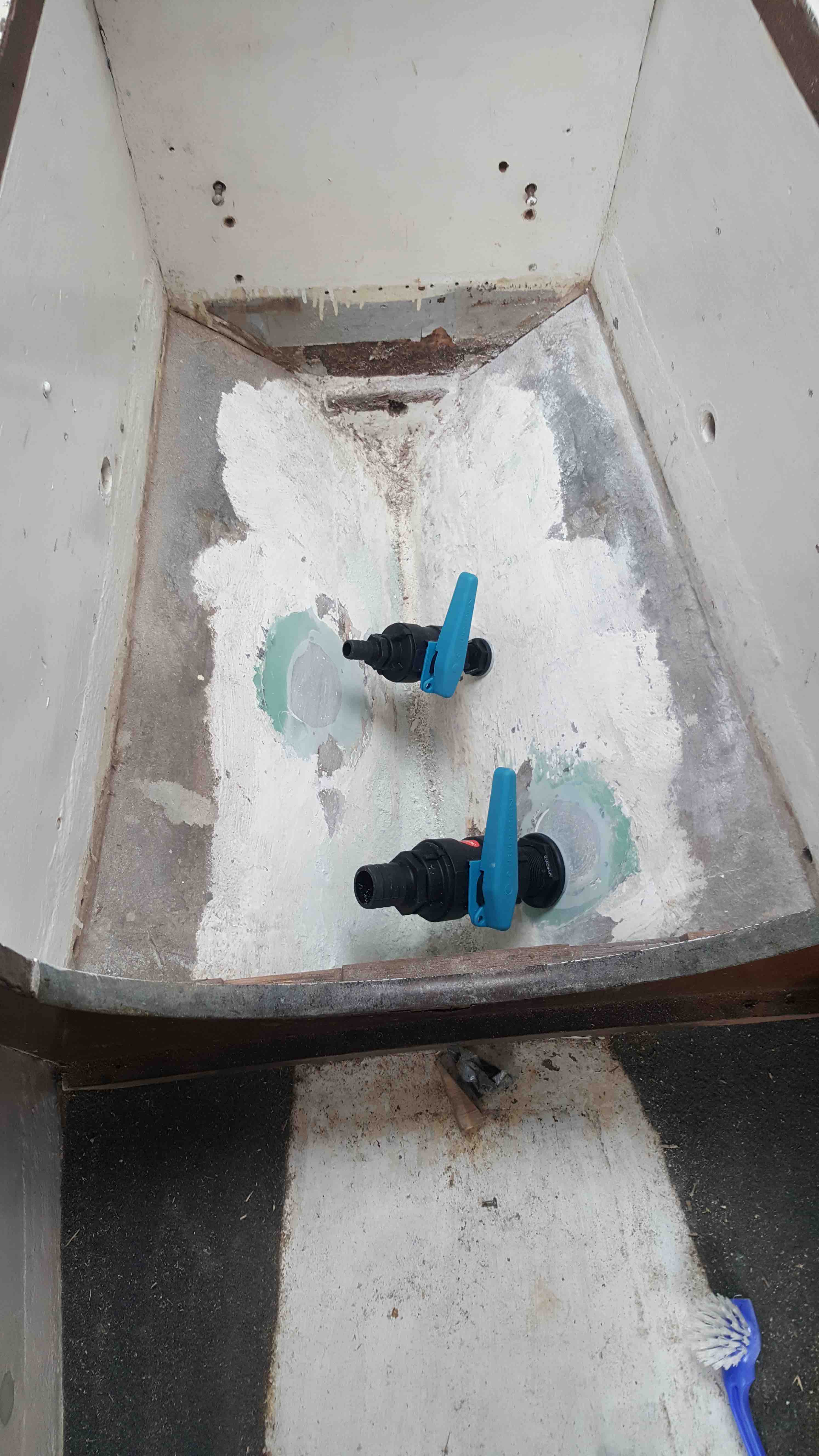

there were 4 thru hulls i removed that were no longer used. 2 were ancient, siezed and unmovable, the other 2 looked okay but were too far forward for where i wanted to run the plumbing
Thru hulls.jpg (607.71 KiB) Viewed 8460 times
Thru hull2.jpg (500.69 KiB) Viewed 8460 times
i glassed over the holes and put in a couple of new trudesign thru hulls + seacocks

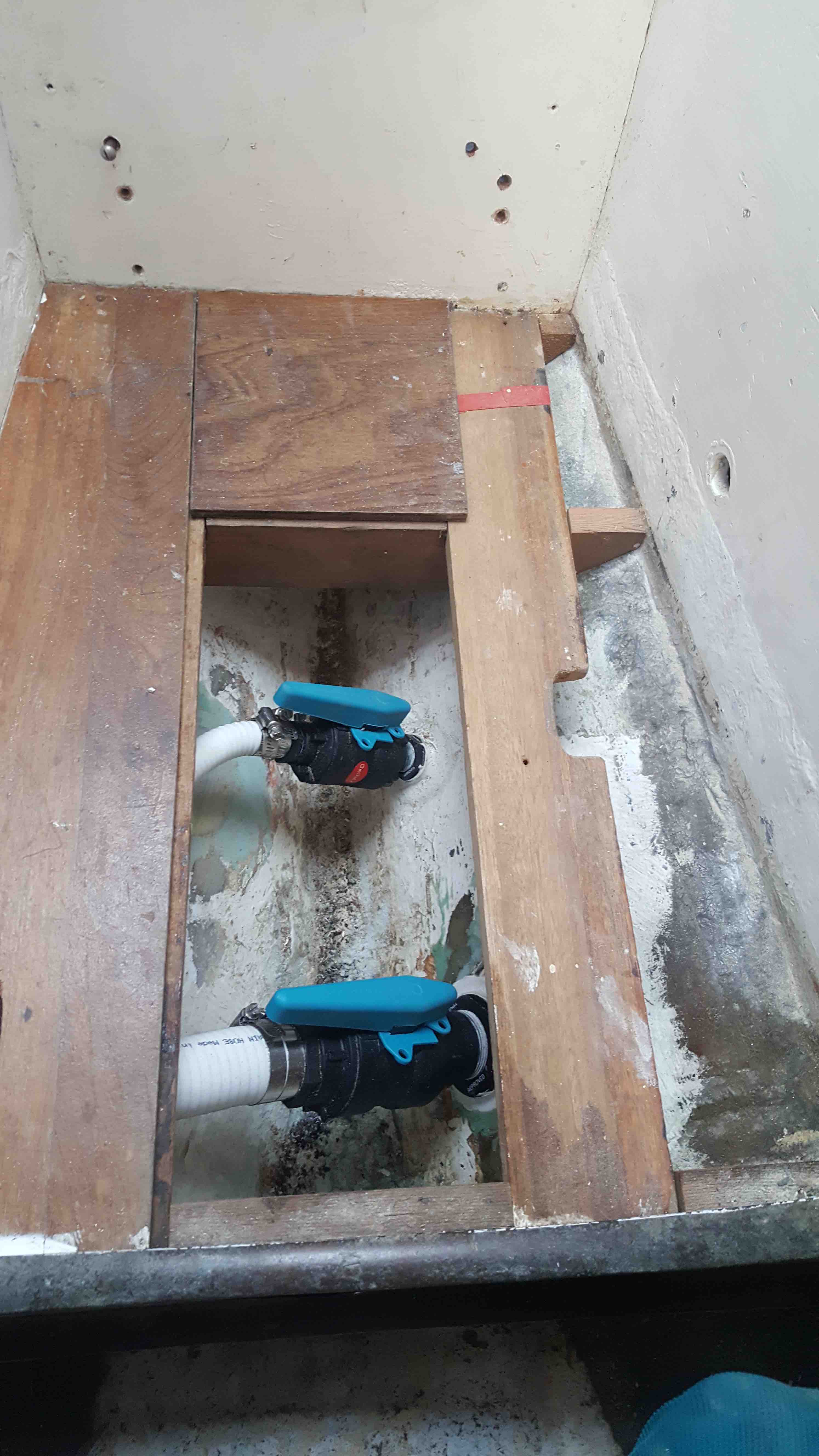

Postby Sailtime » Sun May 28, 2017 6:50 pm

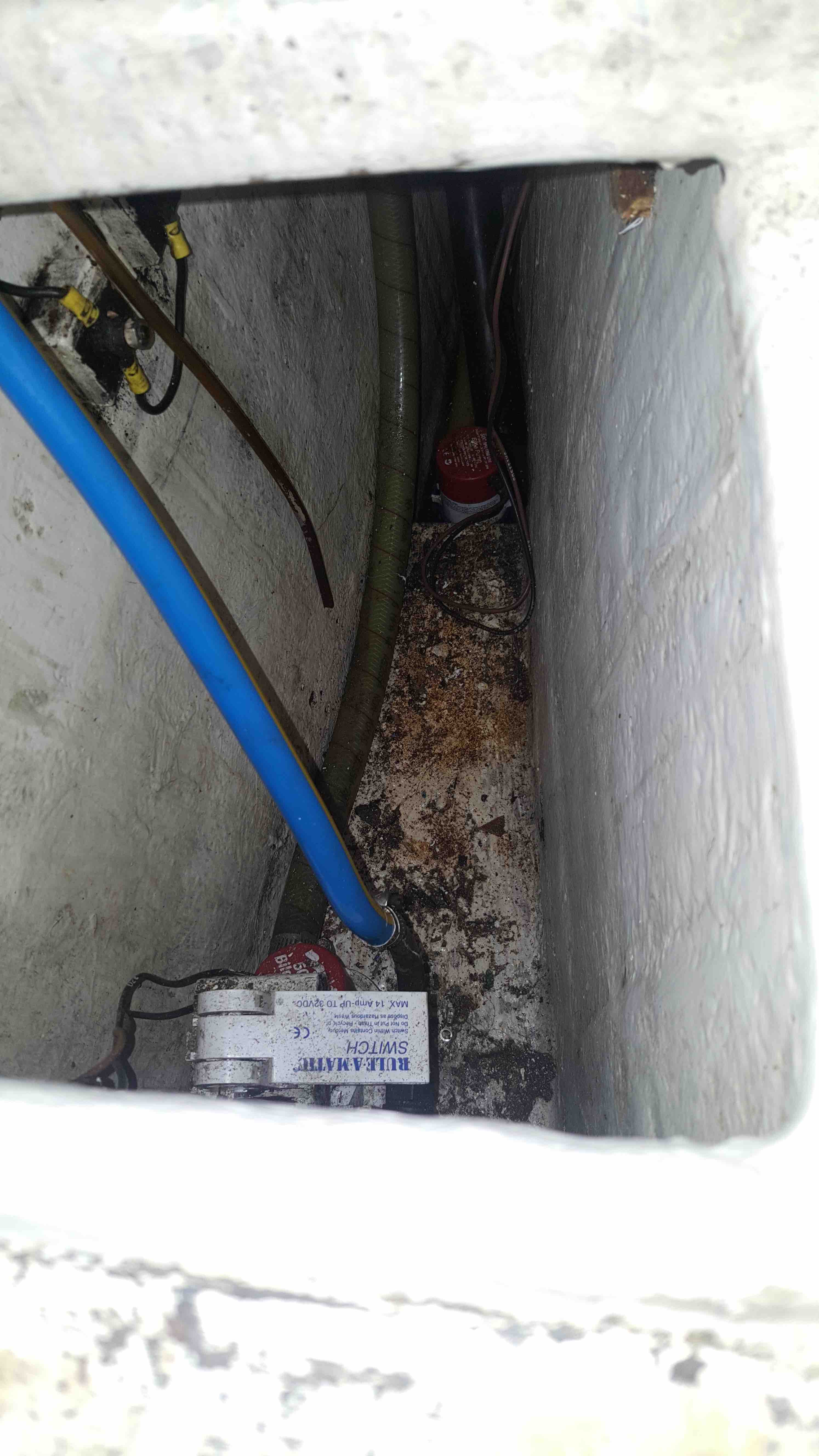

finally hooked the plumbing up.. working with that large hose is like wrestling a giant anaconda

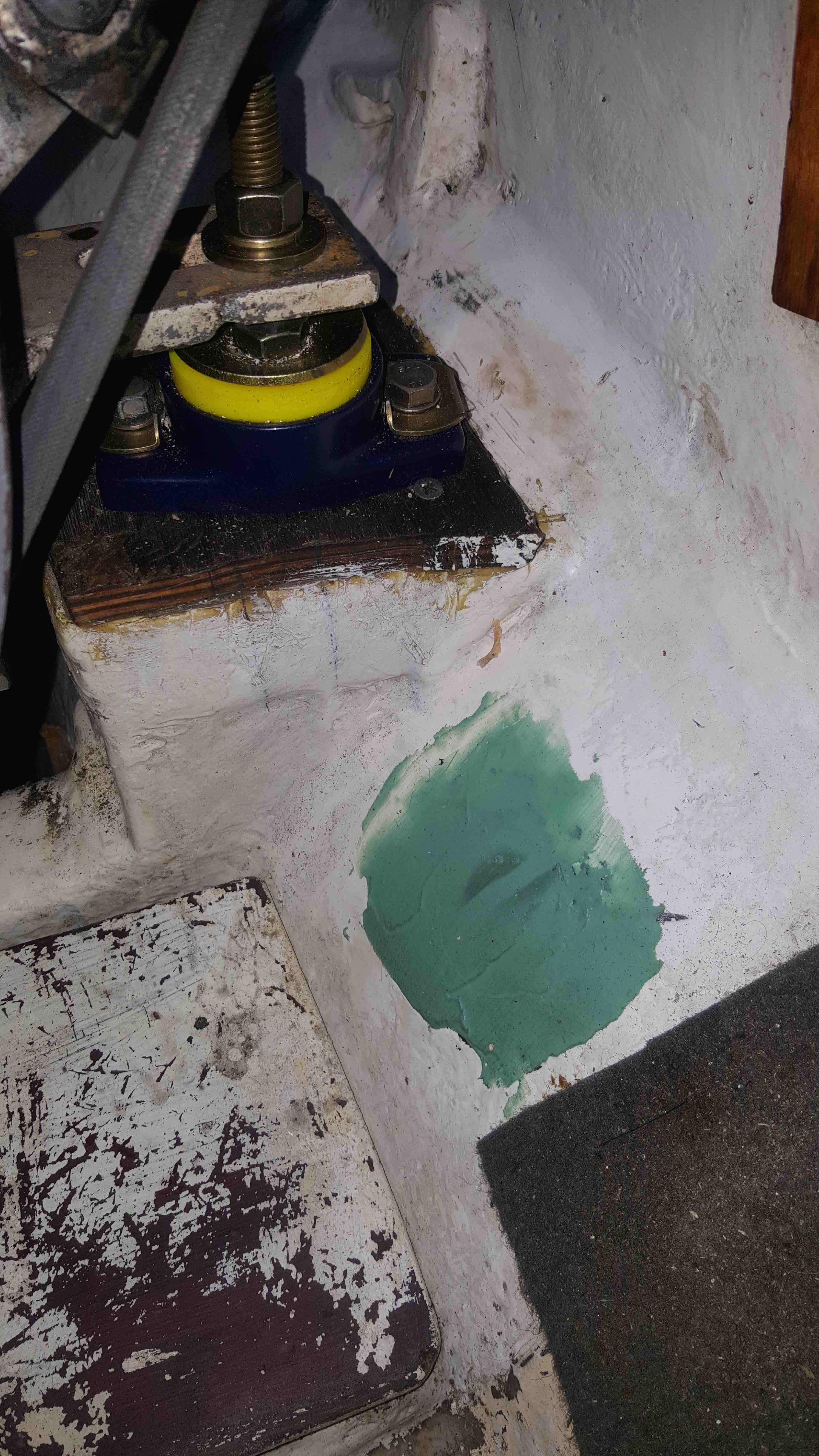

While i was about it i also changed the thru hull + seacock for the engine water intake as suggested by phillip i think as well as the one under the sink so it's new seacocks all round
I had a great time doing this mod which i've been thinking about for sometime
few other little things - while engine was out cleaned bilge of 50 years of oil/gunk, replaced broken bilge pump and replaced the leaking drinking water hose

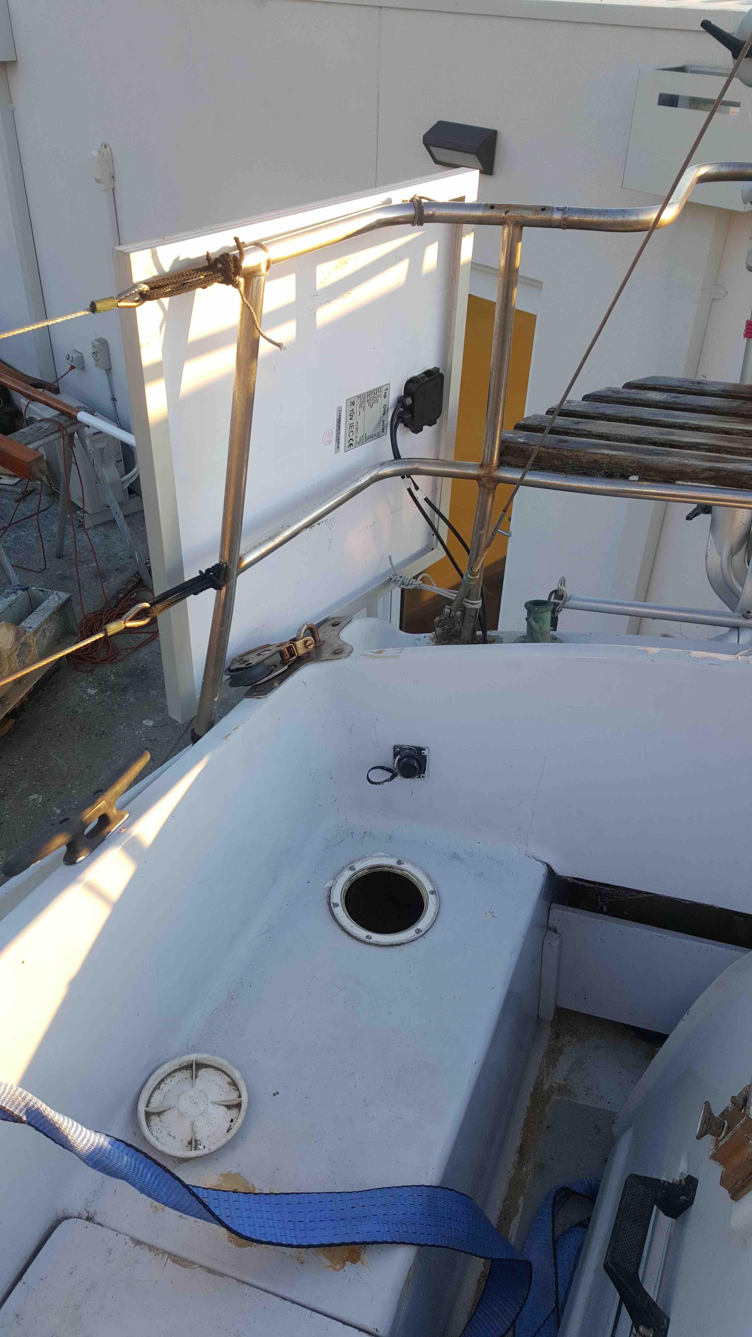

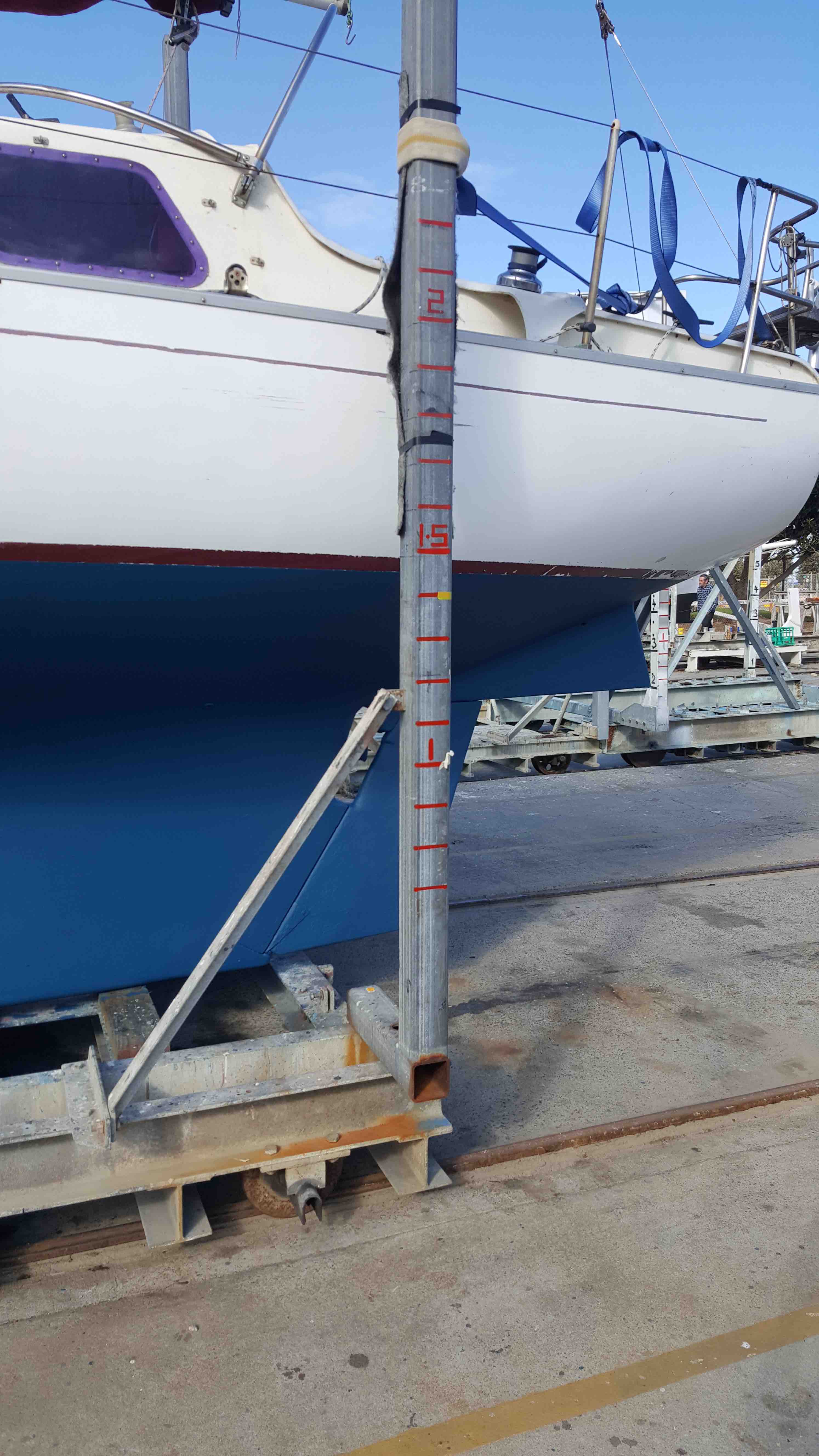

Postby Phillip » Mon May 29, 2017 10:16 pm
Lot of work done there mate! :o Well done!
Tell us, what is the extra fin you have over the top of the rudder in your last photo??
Re: New head
Postby Shaun » Tue May 30, 2017 9:48 am
Very impressive work Shea, good job!
Have you relocated the galley to somewhere else?
I was also wondering what that fin/skeg was above the rudder
Re: New head
Postby Sailtime » Tue May 30, 2017 3:12 pm
yep i have no idea what that little fin thing is.. i've had a few opinions from some old timers at the yard one who thought it may have been added to improve stability in following seas?
dunno..
as far as the galley goes - the sink / icebox etc are on the starboard side, the new toilet is where the big stove/oven was sitting which I've taken out cause we don't use it.
the plan is to get a smaller little gimballed burner happening, at the moment we've been using a little butane burner camp stove sitting on the engine step..
