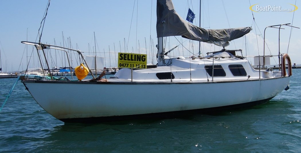

IMAG0601_1 (1).jpg (715.67 KiB) Viewed 6809 times
Hello Phillip,
No evidence of stress, some of the running rigging suggests it has been raced hard. Has a loose foot main fully battened off an S 80. Standard fitout with headin forr'd cabin. Photo of vessel is from the broker when it was for sale. No signs visible of other 8 bolts. I had never been aboard a rigged Tophat before and only just realized the mast bridge was non conforming.

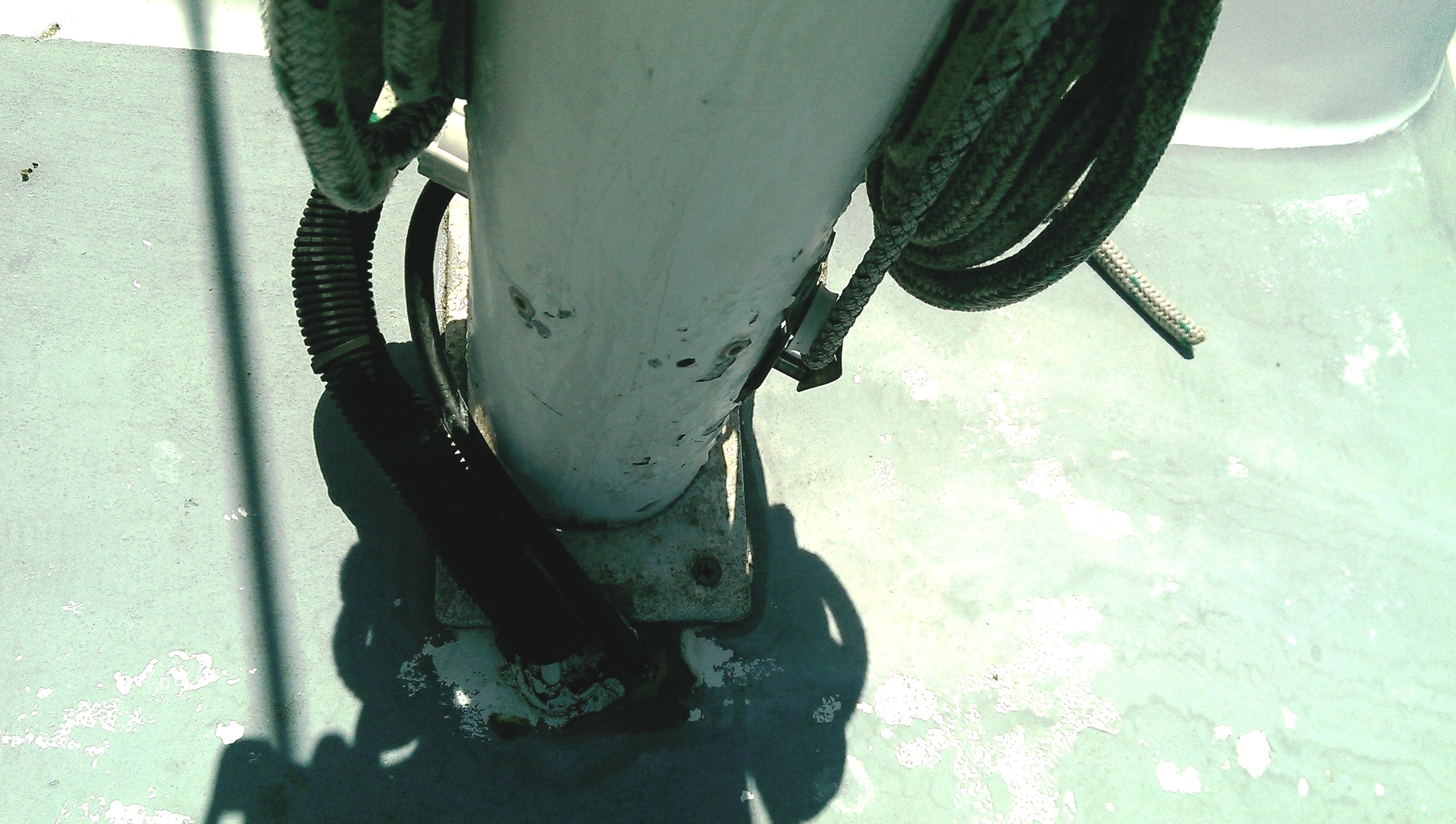

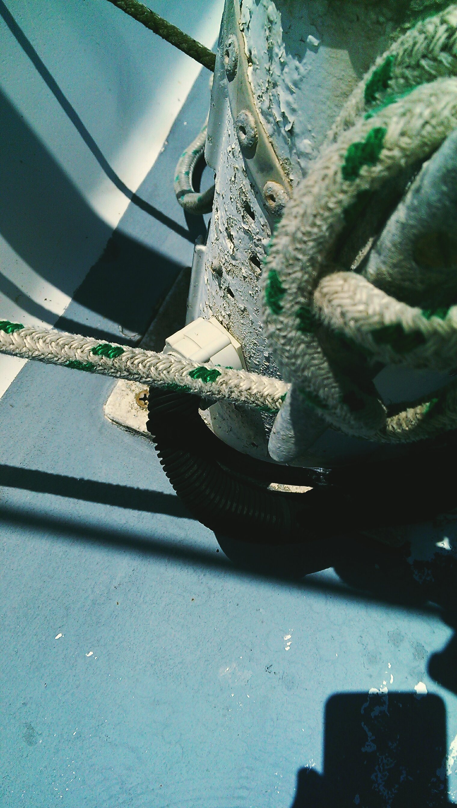

Well I'll be dammed you're right my tophat (Iluka) is missing the mast bridge too! Just had a look at a photo and it has a small stainless plate. I've never noticed any issue with this set up, down below i have double bulkhead between the main cabin the the v birth, I think this takes the mast loads. I have taken the mast out before I think there is an insert that the mast fits on. I'll attach a photo tomorrow.

Picture of iluka's mast base. This was when she was up on the slip, hence the straps arround the mast.

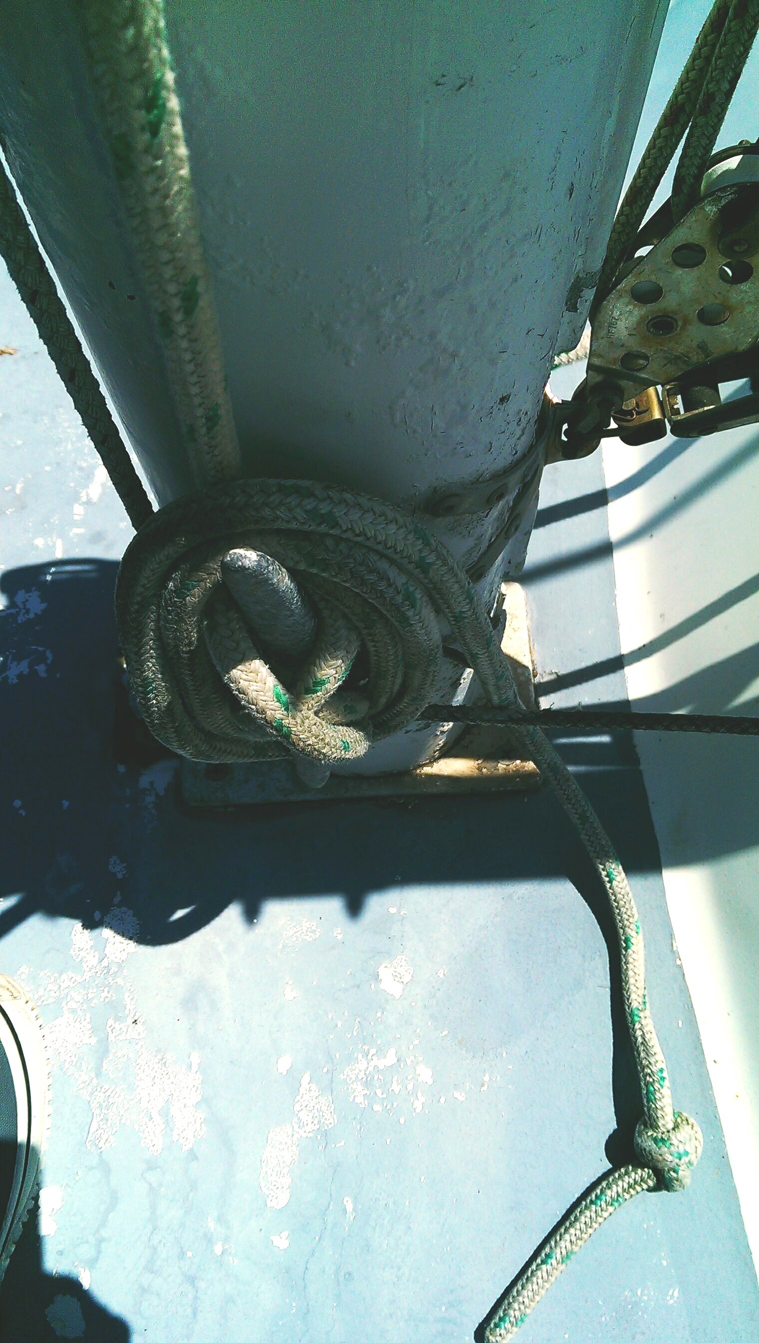

htc 007.jpg (684.41 KiB) Viewed 6776 times
htc 014.jpg (1.3 MiB) Viewed 6776 times
Same setup with a more elaborate plate. Mine is bare basic. Glad to see I'm not Robinson Crusoe I was worried some bodgy fix had been undertaken. Amante has a transom cutout, it took me back a bit when I first saw it,as I had only ever seen wells, searched the site a bit & saw others.The gallery shot of Iluka shows a nice looking mk1& I was relieved to see the mast .Fair bit of work to be done on Amante to look half as good as all is a bit rough & neglected but seems to be as solid as a rock. Needs slipping something fierce & new running rigging , the main halyard sheave block does'nt roll freely only goes about 1/2 way up , the mast will have to come down.
