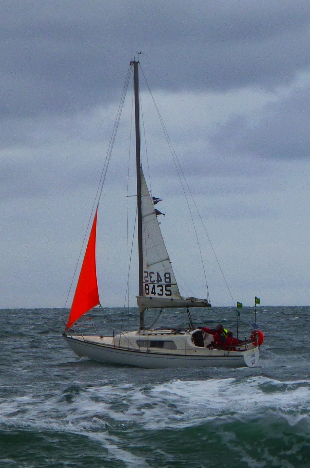

Postby Phillip » Sun Jun 26, 2016 3:10 pm
Seeing Tom's photo that's how I had my storm jib rigged too.
The only time I have used it was when Shaun, in Blue Moon, and I, in Seaka, were going to Sydney and were caught by a Black NorthEaster.
I eventually dropped the main and raise my storm jib on its own, anything else was just too much sail.
We were still doing 4 + Knots but Seaka was under control.
So yes you can get caught out there and the day had started off so beautiful with flat seas and about 10 knots of NE wind...perfect.
