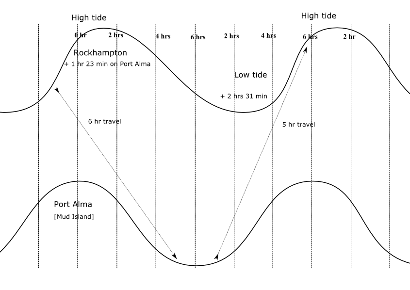

I find your idea of the semicircle interesting. I actually had some problems trying to visualise the tide at Rockhampton and the tide way down river as they are different by an hour or so and going down/ up river I need to understand both. So, after much head scratching, I drew a diagram of the two tides, one curve above the other set on a time line. This is how I use it. I pick the point on the tide I am leaving Rockhampton [top curve in diagram]. I am wanting to go down to the coast. That can take 6 hours with tide. I go right along the time line 6 hours and down to the bottom tide curve. Where the 6 hours touches the bottom curve that is what the level of tide will be when I get down there.
Basically, I could easily see that leaving several hours before high tide in Rockhampton gets me safely down to the river mouth before low tide. I found the diagram helped me heaps. Now I don't use the diagram as much as I can understand the tides better.

You can see from the diagram that Rockhampton has 7 hrs of fall and 5 hr of rise.
Maybe if I carry in the boat some paper with semicircles marked then I could easily do the tide calculations.
