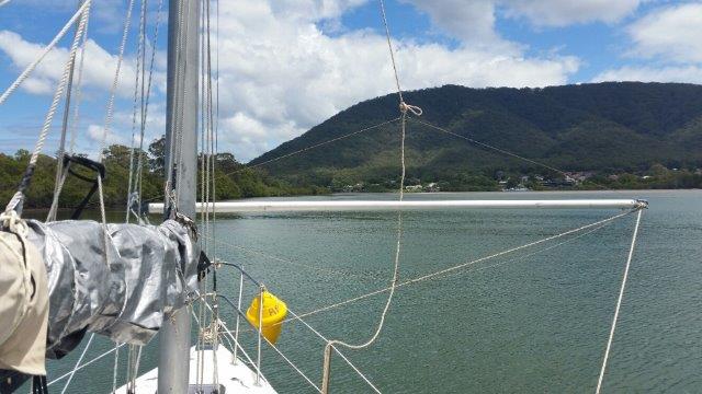

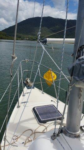

Thanks for that link on the Twizzle rig Mike, because I cant connect the inboard end of a whisker pole the mast (not high enough anyway, don't want to connect it lower than the boom),
a similar set-up might work to get a pole out.
I did a rough mock up with a spinnaker pole & it was surprisingly stiff, with dedicated lines, with knots etc at the correct lengths etc, to allow it to be put up quickly & easily at sea, it might just work, as I'd only be attempting it in very light winds.
