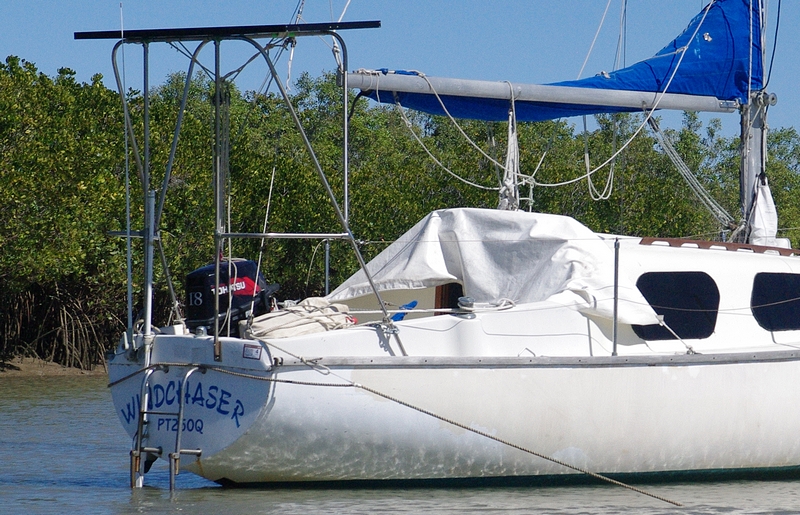

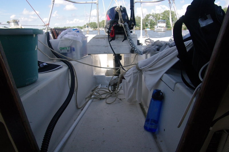

My outboard, being electric start 18 hp, even though a 2 stroke weighs close to 50 kg, which is a considerable amount. I use a 4 pully system although the bottom pulley is actually two in one. So, the rope is tied up on the solar panel frame, goes down through the pulley tied to the motor (roller 1), up to Pulley-1 tied to frame, down to roller 2 and up to Pulley-2 where it comes out and I pull on it. Don't know what the mechanical advantage is but I think I only pull about 15 kg (would be less if pulleys were good ones).
s outboard lifted.jpg (451.52 KiB) Viewed 13964 times
When up, I usually just hold the rope in one hand and slide a board across the seats and lower the motor onto it. Or if one hand not enough, I can cleat the rope off to the side and use both hands on the board.
s outboard 2.jpg (362.36 KiB) Viewed 13964 times
Originally I had all sorts of problems with getting the motor up, especially as it needs to go a bit sideways to come up, but now I find it quick. If I wanted to, I could probably run the rope through the cockpit winch and winch it up. However, I found when I first started lifting the motor up, I needed to put on an extra pulley or two and made it so much easier. One pulley would be the whole weight but four pulleys means about 1/4 the weight on the pulling rope so much easier. Could use even more to gain even better mechanical advantage.
