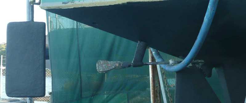

by Dolphin
G'Day Rob and Mark,
Here is a photo I hope helps shows the setup on a Mk III.
I would also recommend, if you can afford it to fit a folding prop. The sailing performance is really good.
I just (2 years ago) had the Hatz (BMW) Diesel replaced with a Volvo 12 Hp. There were minumum mods to be done and that cost 10k for the engine and 4k for the fitting. Do you really need a 15Hp, maybe you could save a bit there, but at the same time its probably good to have a bit of power up your sleeve.
I put a rudder on the transom as the slow speed manoueverability was, I thought, bad. Mark??
Cut and paste the pcture to see the whole shaft.
