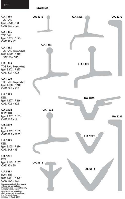

Attn Bear and everyone else - especially anyone who has an aluminium toe rail.
I am having a shipwright take a look and he has suggested looking at perhaps aluminium especially as I would like to have some fairleads.
Does anyone know what profile is needed and where to buy it?
Also does anyone have fairleads with a timber toe rail?
How do you get around the 'lip' raised bizzo where the deck and the hull join.
Doesn't it have to be flat to be able to install fairleads?
Re: Replacing a Toe Rail
Postby bearmcnally » Wed May 16, 2012 7:16 pm
Hello Diana
Here are some profiles and the address
Ullrich Aluminum 185-187 Woodpark Road, Smithfield, NSW 2164 PO Box 2182, Smithfield 2164
Phone 8787 7400
al toerail.jpg (40.57 KiB) Viewed 14111 times
Postby Shaun » Wed May 16, 2012 8:19 pm
Hi Diana,
I'll be interested to hear what the shipwright suggests.
You will likely find the "raised lip bizzo" is hollow, so anything drilled through the raised area will need to be drilled oversize, filled with epoxy then re-drilled the correct size.
I drilled a 10-ish mm hole under the small crack-line (to act as a scupper) in the photos in this thread viewtopic.php?f=3&t=672 & it was hollow.
