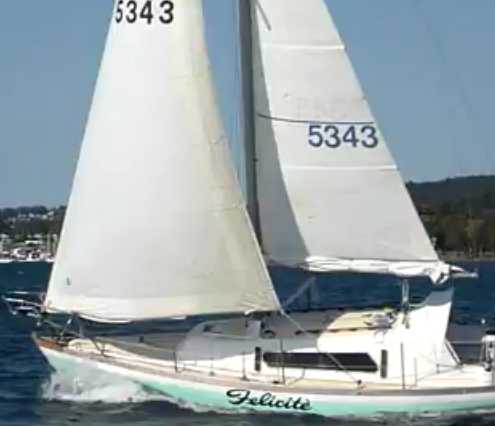

Kevin that is the standard way of reefing.
Like Mike,
Sailing close hauled about 60 degrees from the wind on the Genoa,
1) Let the main sheet out so that the main is flapping.
2) I put the topping lift on the boom, well its on all the time, just to support the boom.
3) Lower the main halyard, pull the pin out of the track and let go 3 sail slugs, for the No 2 reef.
4) Hook the tack, the reefpoint on the luff of the sail over the horn at the gooseneck.
5) haul the halyard back up and tension it.
6) haul in the reef line and cleat it off, (mine is on the boom).
7) With 4 pieces of 6mm line I then take in all the slack sail and tie it around the foot of the sail. NOT THE BOOM!.
8) Sheet on and away you go.

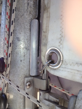

Postby Tales » Sun Jun 03, 2012 1:47 pm
John (K)
Send me a PM. You can have my old main cover - needs a small repair.
I made up a single line reefing system (three reefs) similar to what others have described above.
Means you don't have to leave the cockpit to reef.
Takes about 20 to 40 seconds to put in a reef. Tidy up the lines, another minute.
Also made up a plate to hold the sail slugs see pic.
Let me know if you want further details.
Gate plate.jpg (62.66 KiB) Viewed 15480 times
