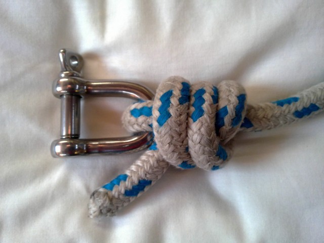

I use 10mm spectra and make the jib and main halyard the same length.
You can end for end them both at the same time by stiching the ends to each other and just pulling them through.

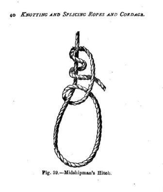

A couple more knots worth considering.
For all you Midshipmen

Found on new Jeanuau sailing boats
