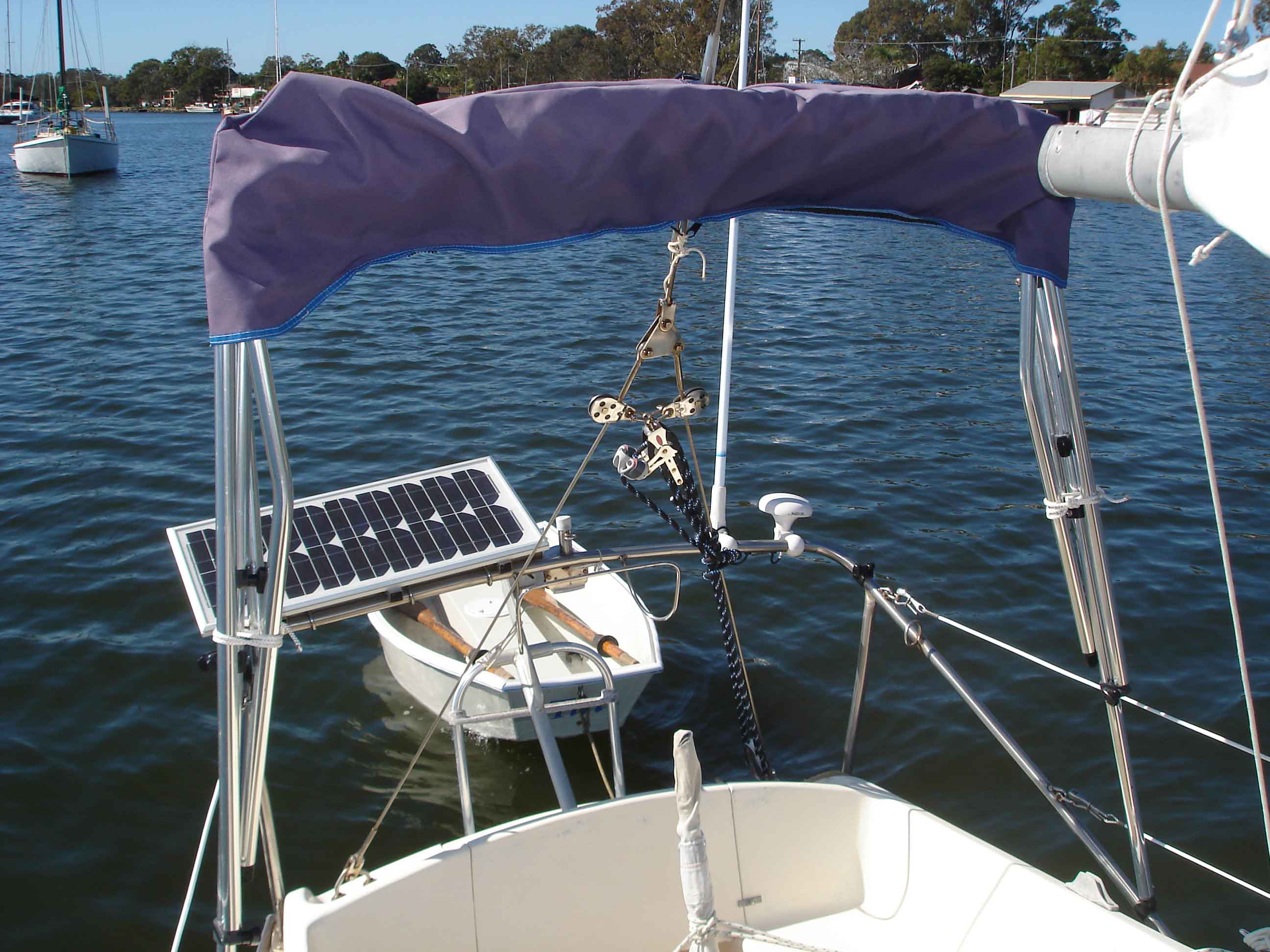

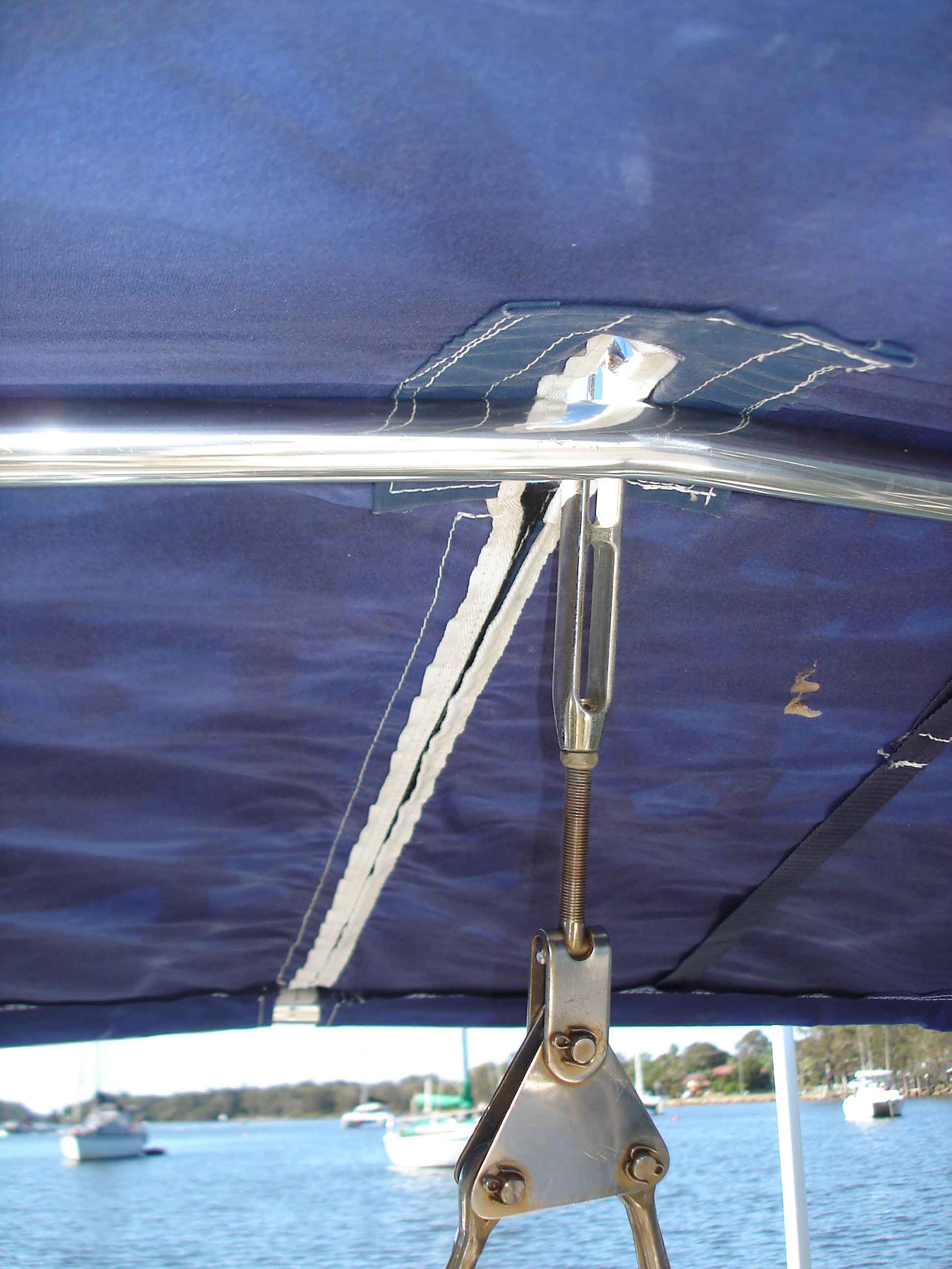

I like to know about how did you put the back stay though the canvas?
as far as the other tubeings, I 'll need to work it out myself , because Sylph is a mkIII .
8philip8
8philip8
Re: Spray doger and bimini
Postby Phillip » Mon Mar 15, 2010 9:23 am
Hi Philip,
You have to have the Bimi cut from the rear frame up to your backstay and have velcro sown on so you can close and open the cut. You must also have the area around where the backstay goes through trimed with canvas to prevent fraying of your bimi canvas.
I'm have included the best photo I have showing the bimi. Sorry I took so long to post this.
P h i l l i p

Postby 8philip8 » Mon Mar 15, 2010 8:37 pm
hi Philip
the photo is most helpful.
thanks :D
did you undo any stitching at the back ?
8phipip8
8philip8
Postby Phillip » Mon Mar 15, 2010 9:33 pm
We had to unstitch a little each side of the cut to allow the pocket,
for the back tube, to be trimmed so it would not come apart.
Tube pocket was then resown.

Hope you enjoyed today. Here is a photo of the bimni folded up.
P h i l l i p
SEAKLA
Bimini folded up on SEAKA
