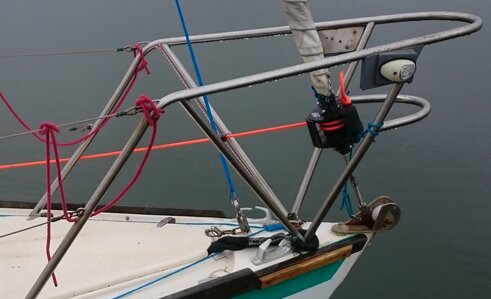

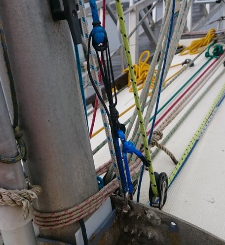

The photos below show the Solent stay at the bow and the tensioning method at the mast.
The stay (blue Dyneema) is about 400mm back from the forestay. It runs through a spare genoa halyard sheave at the masthead and back down inside the mast. It is tensioned at the base of the mast by 3mm grey Dyneema running through low friction rings, ratio 6:1.
The Solent stay and forestay get closer together as they get nearer the masthead. The sails on the Solent stay stop well short of the masthead. Therefore I don't think the stays getting closer will be a problem.
I will probably attach the Solent stay to the front of the mast in the conventional manner next time I take the mast down. I will then tension it with a Highfield lever at the bow. Attaching it to the front of the mast will halve the length of the Dyneema (reducing stretch) and take the force off the masthead sheave. I think the existing sheave is metal as it was installed for a wire halyard so should be all right in the short term.
I can use my old genoa halyard to raise the sail on the Solent stay as the roller furler on the forestay has an integral sheave at the top and its halyard returns back down to the drum.

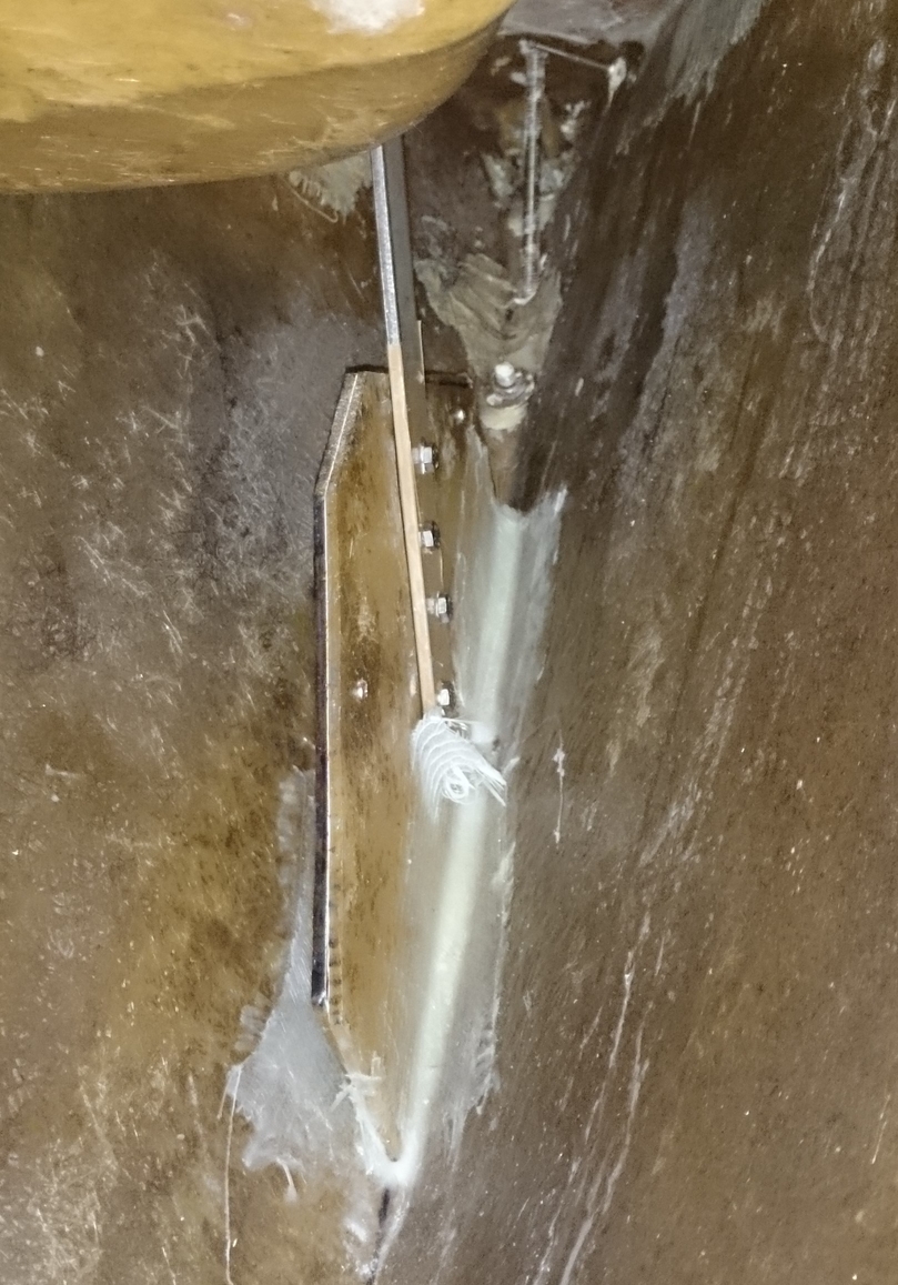

As requested, here is a photo of the attachment of the stainless bar to the stem. It is difficult to reach this area. The result is an untidy job.
The vertical fibreglass sheet is about 300mm long with a curved edge to roughly follow the curve of the stem. The sheet where visible in the photo is actually two 4mm thick sheets, with two smaller sheets of similar thickness on the far side (not visible), giving a total thickness of 16mm where the bolts penetrate it.
The sheet is bedded in thickened epoxy where it meets the stem, with thickened epoxy fillets covered by a few layers of fibreglass.
The stainless bar is also bolted to a plywood sheet just under the deck. This plywood sheet is part of the original construction on my Mark 3. It is a vertical sheet running on the boat's centreline, starting at the front of the anchor well. You can only see it if you lie on your back and get you head right up near the bow. The stainless bar has to run alongside it and can be bolted to it which should stop any movement between the bar and the deck.

Re: Staysail on a TH
Postby Macintechno » Wed Jul 21, 2021 8:57 am
Thank you Steve,
The area is a bit tricky to reach for sure.
I think it looks like a solid job though. Well done.
I’ve ripped the anchor well out and increased it in size so that type of work will be a lot easier for me as I can work from above deck.
It’s something I seriously consider and your pictures help me a lot for the planning.
