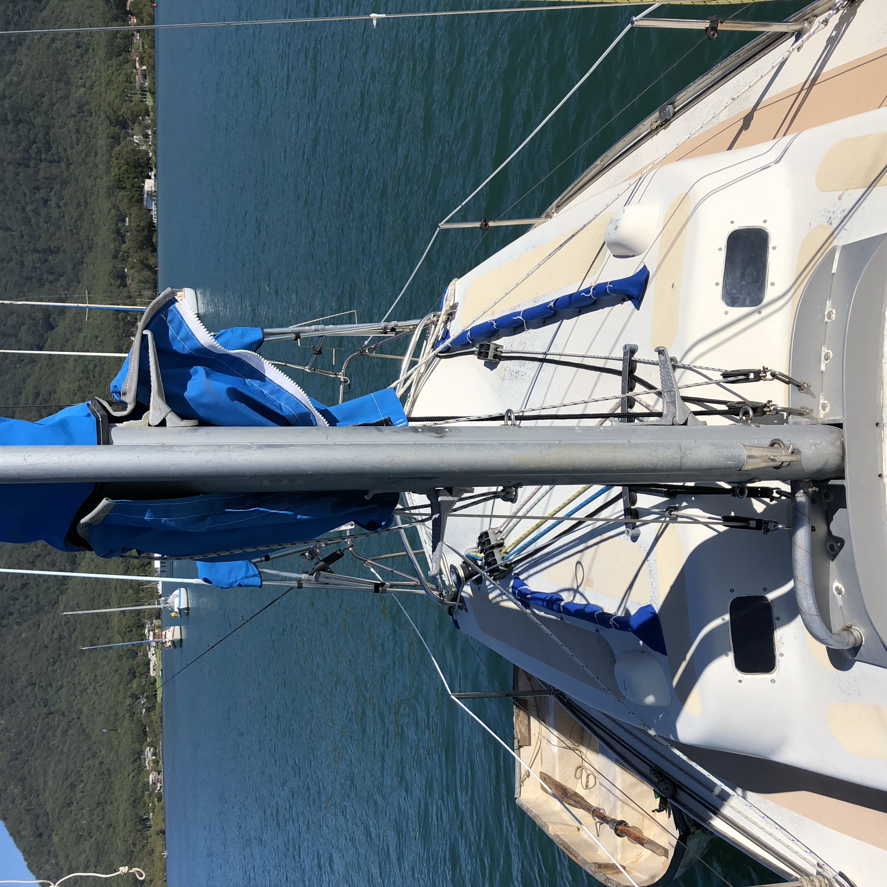

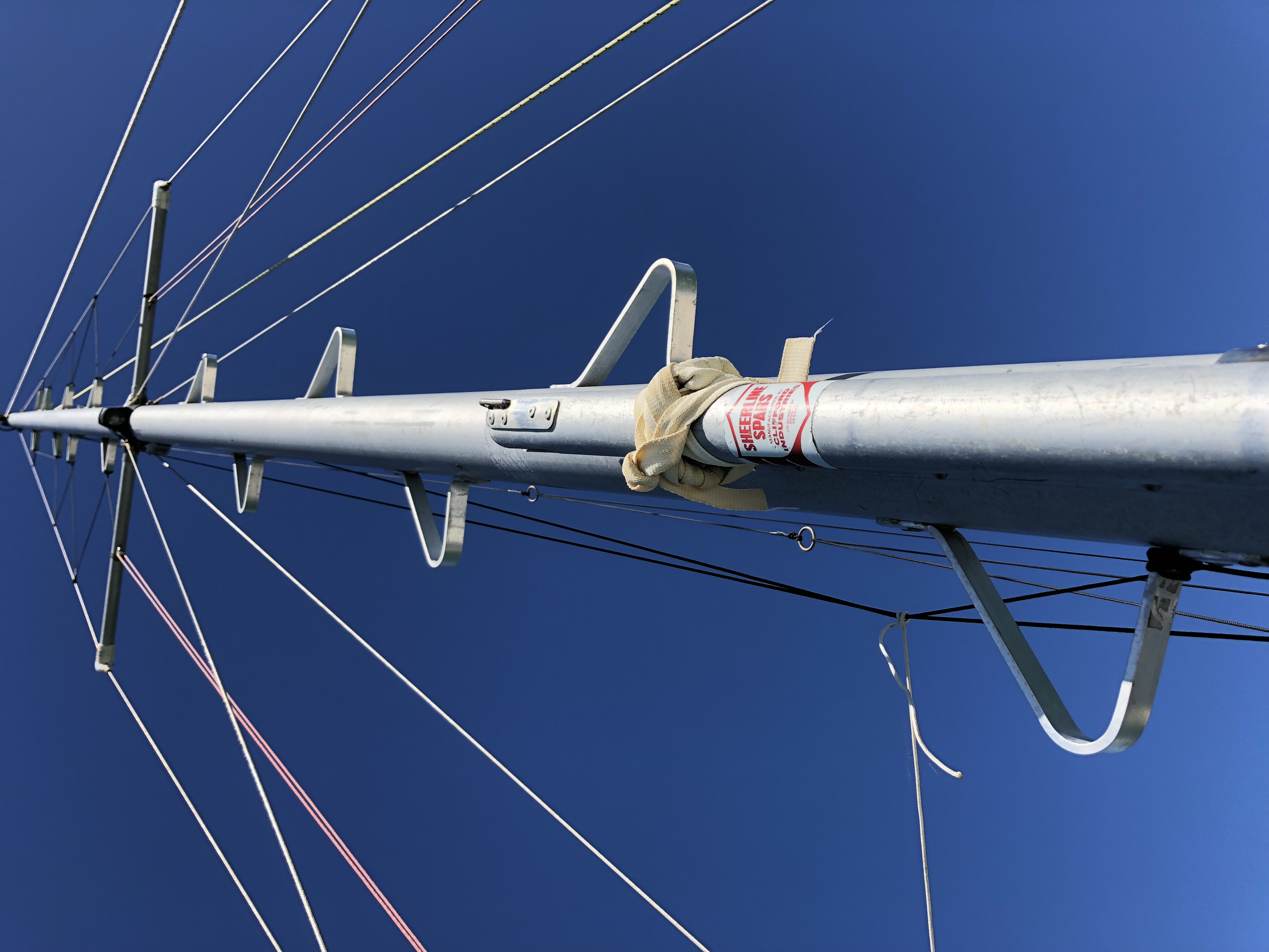

The mast above the boom
Folding steps below the boom

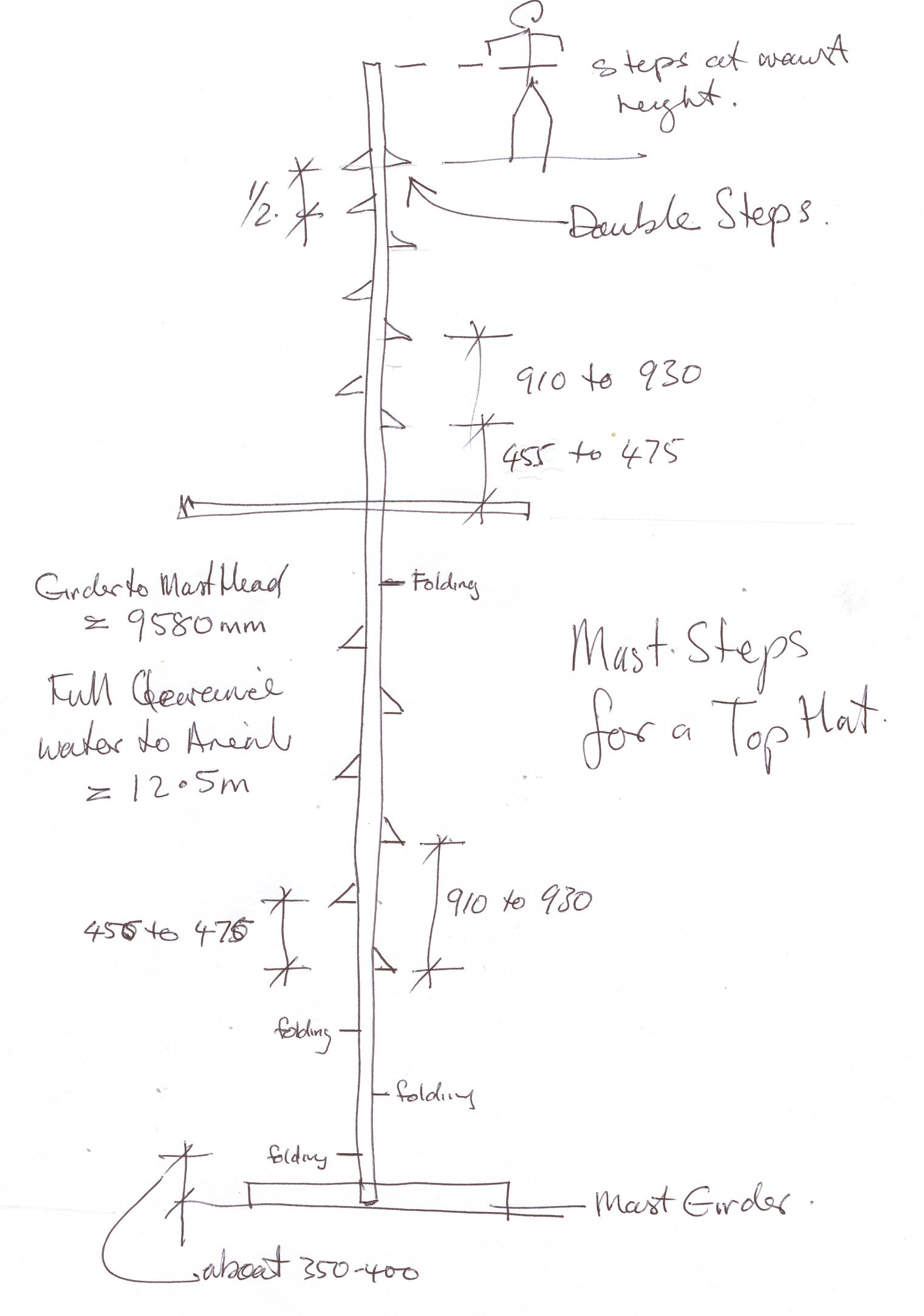

Well it’s taken sometime but at last I’m ready to start on my mast steps......thanks for the inventory list Phillip.....just one last question....how far apart did you space your steps?

Postby Phillip » Wed Oct 24, 2018 9:28 pm
mast steps for Top Hat.jpg (758.67 KiB) Viewed 8460 times
This diagram should answer some of your questions :D
