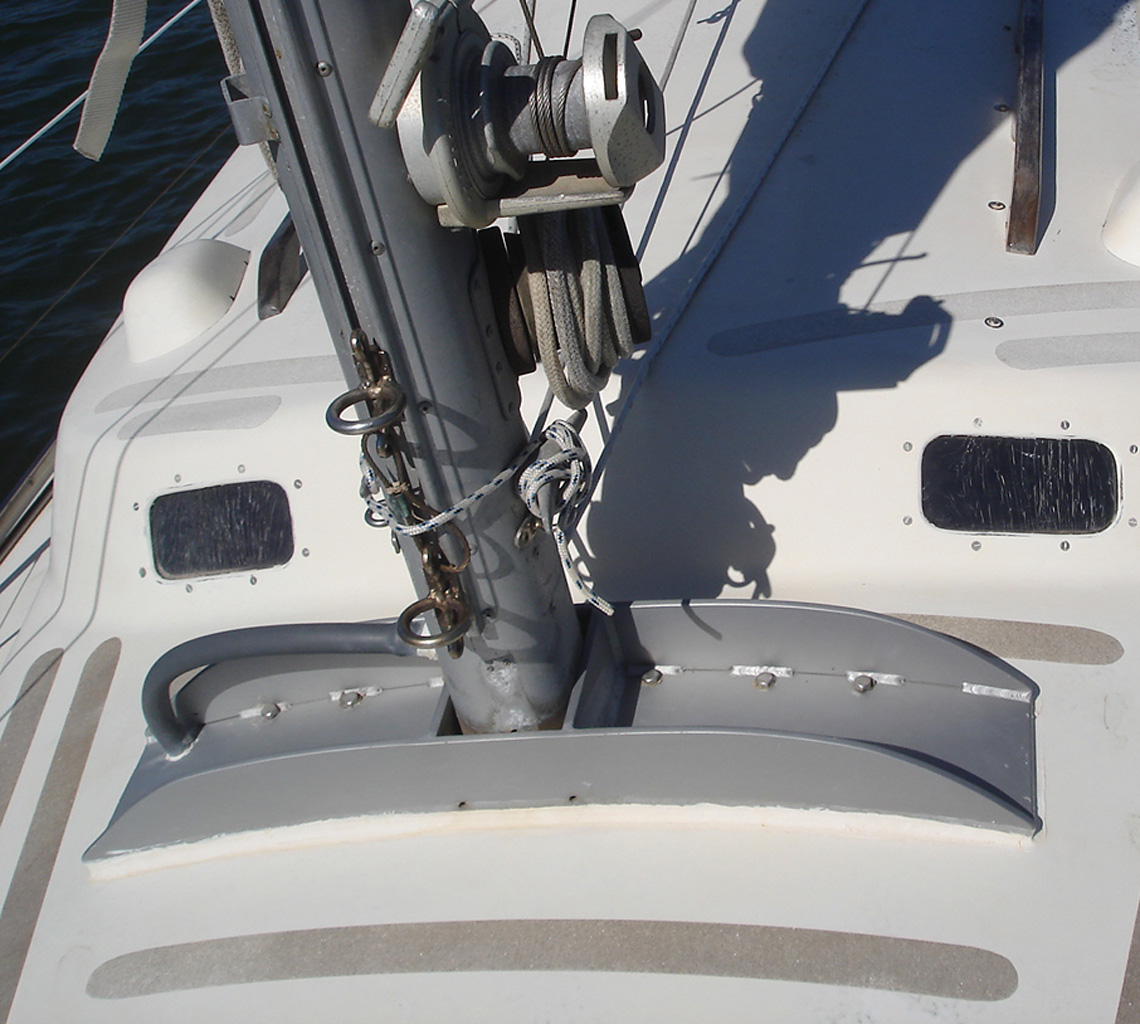

My mast girder is made of aluminium and is envied by all who see it.

Looks very nice Phil. I am jealous. You may need to clarify, what is the difference between a step and a girder? wouldn't the lump of metal under a top hats mast be both?
