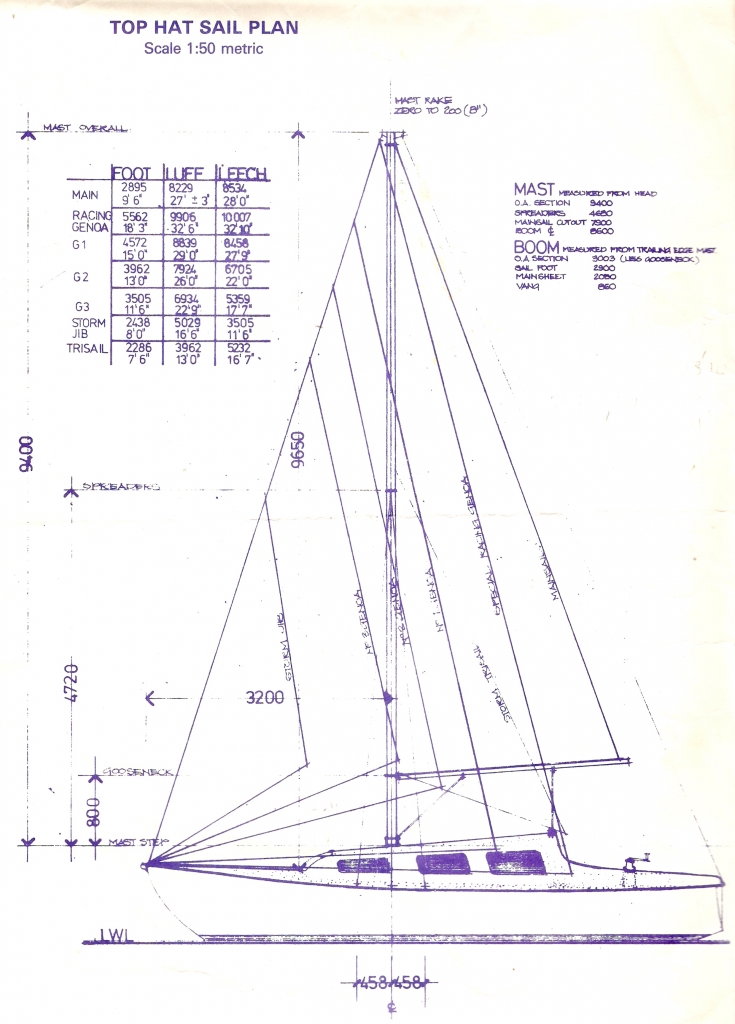

I am about to replace all halyards on The Wayward Lady with 10mm Spectra. I would like to know if anyone, who has done likewise, and can inform me of the respective lengths of the halyards?

Kevin, The sail plan diagram for the MkIII on this link may help.
http://tophatyachts.com/gallery/image.p ... w=no_count
