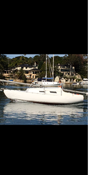

Yesterday was big day for the old Dawn, we have a reliable motor!!
Yesterday morning we motored from lane cove river to rose bay under our own steam and back again, with only a one hick up! which doesn't sound like much i know but for the past 18 months she hasn't left the river and it was awesome to wipe off the slim it had grown.
When i left we got to about the middle of rose bay and it cut out, turns out the fuel plug had block along with the bulb, i fixed the bulb while drifting towards the beach but didn't have time for the plug so i ended up just putting the fuel line in the tank. You would have no idea how much fuel comes flying out under the bridge. This week after work I'm hoping to install the stainless tank that the boat came with and mount the key switch and battery box in the cock pit locker.
The Dawn motors just shy of full throttle at 6.0 knots, which i think is almost hull speed as we pull a small swell and bury the transom.
What speed do other toppy's do?

Congratulations Aaron on your first journey in Dawn Breaker. 6knots is about max under power. I can do a little more with my 15hp diesel but to do so I have to block the rear cockpit drain or get wet feet due to the yacht sitting low aft. When do you think you will get the sails up?

Congratulations Aaron, it certainly is a great feeling to have ya boat moving with a reliable motor.
Do you lift the motor up when Dawn is moored?
My motor is 18 hp Tohatsu 2 stroke and the PO modified the well to fit it, however, I would like to see pics of your modification when you have time.
With speed, I consider 5 to 6 knts to be a good cruising speed. I did a few hours at 8 knots the other day using half throttle but that was going with a rising tide of about 4.5 metres so it was racing in. : )
