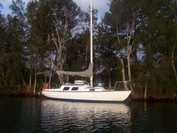

Postby Phillip » Wed Aug 05, 2009 4:23 pm
Good Afternoon Scott, Mark and All,
I have attached a photo of a Top Hat Mk 1 that was for sale around October last year with a life raft.
